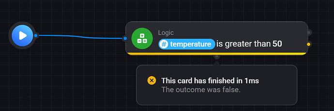

I created the variable “temperature” as a number in the screen of the flows.
The flow is extremely simple:
But as you can see the logic is saying the temperature is not greater than 50 despite the fact that the variable and script is saying 73.8
What am I doing wrong?
