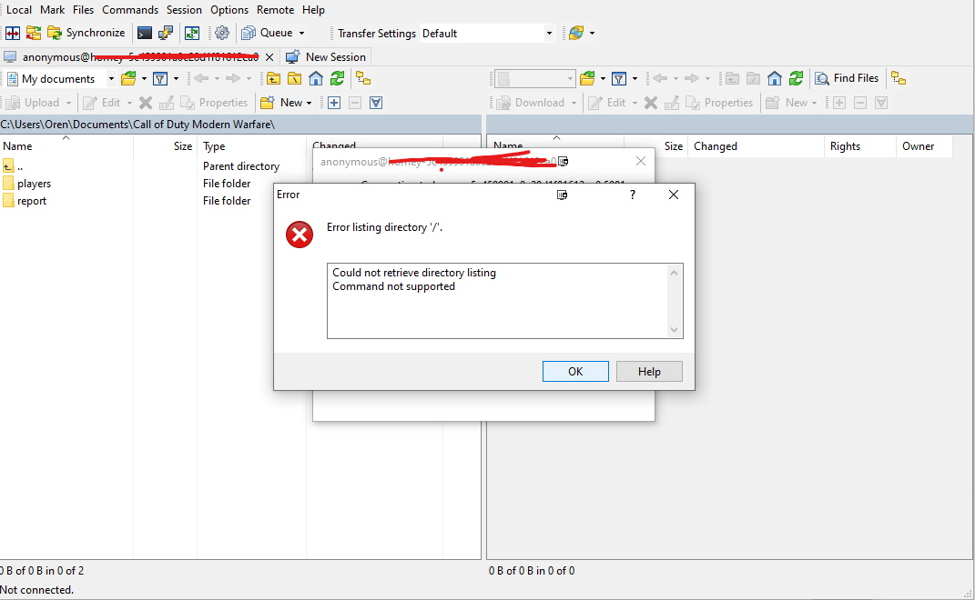

i am able to connect to the server but i cant open folders and create or copy any files to the server
i added photo of what i wrote in the ftp client app
this is the error i get if i try to do any action
Use FileZilla for this, that works. WinSCP does not work here.

hmm… I am still wondering about the error message. I just tried to reproduce what your log shows. And it does also work with options after the LIST command. I would suspect that the data store was not initialized correctly. Can you try restarting the WebServer app and then try connect with filezilla again?
If the error message persists. Go into the Homey app → More → Apps → Micro WebServer → Small Gear Icon → Generate Diagnostic Report
Then I will have a look at the app log for you. Maybe I can see something there.
