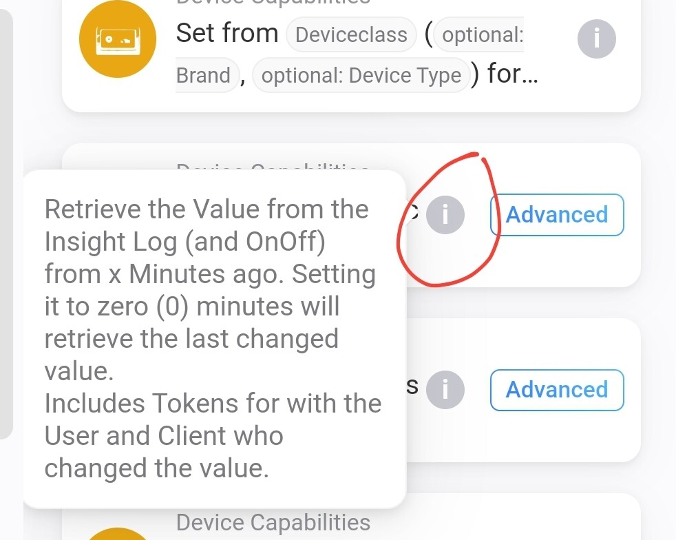

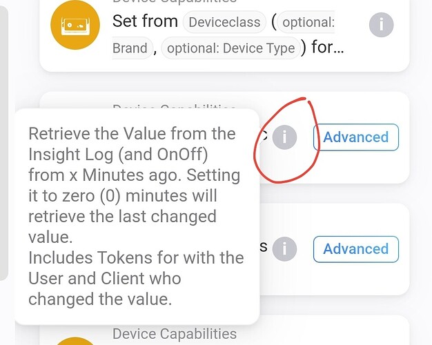

Most flowcards have helpers, and you should just follow the examples
And in advanced flow, just hover the (i)
