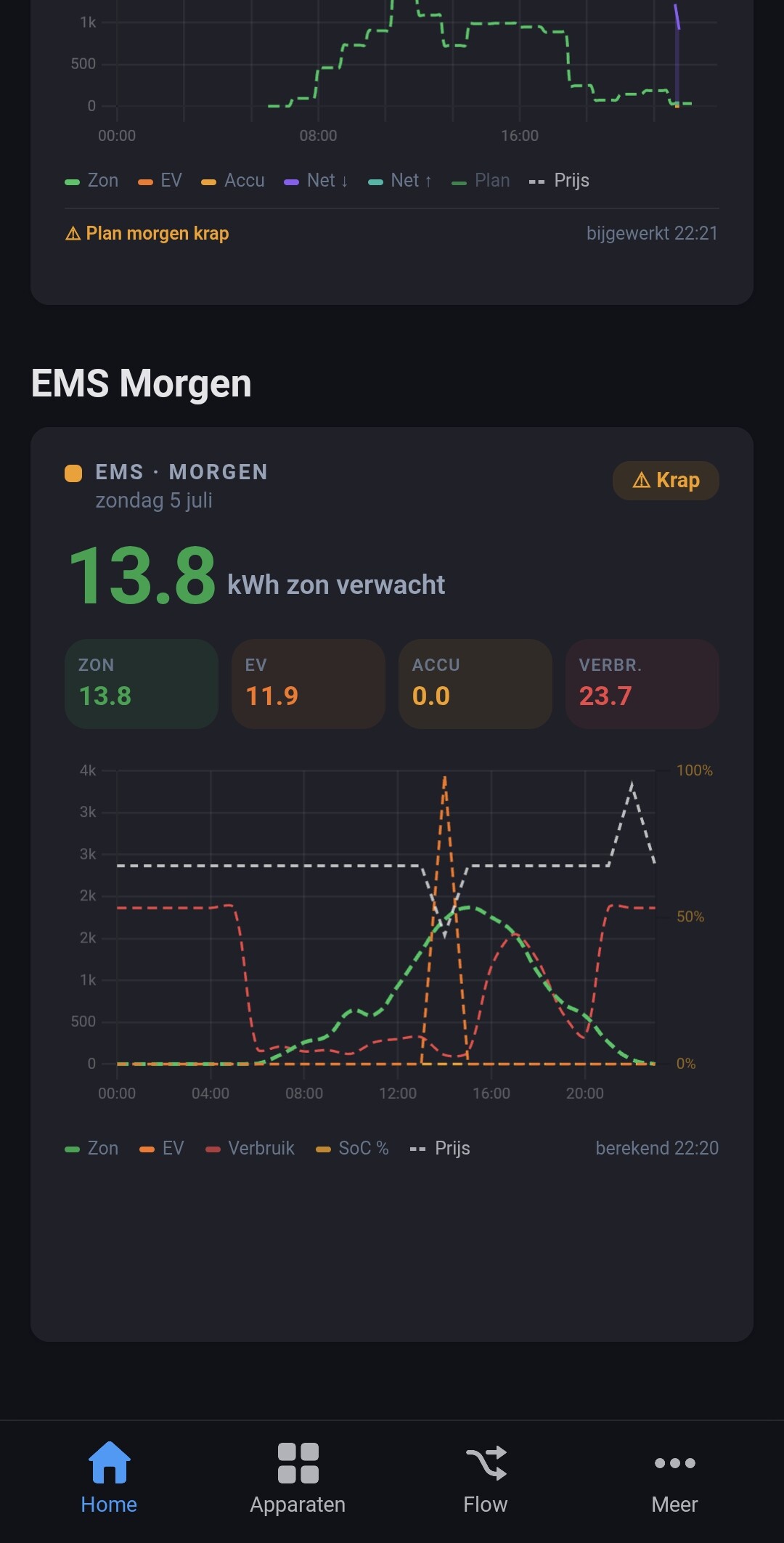

Thanks for building Ultimate EMS, it looks very promising! I just have one question.
I assumed that the EMS would schedule EV charging during the cheapest hours of my dynamic electricity tariff. However, whenever I plug in my car, the EMS detects it and immediately starts charging, even when the electricity price is high.
My setup is:
- Tesla connected through the Tesla Car & Energy app
- HomeWizard P1 meter
- Solar panels connected through the Zeversolar Cloud app
- Dynamic electricity tariff via PBTH
I’ve tried several charging modes, but the result is always the same. I haven’t created any flows because I assumed the EMS would handle this automatically.
What am I doing wrong?
Thanks,
Raymond
What was the soc of your Tesla? Did you also added the widgets? Can you send met your bug report and or log file? Als mention the times that you experienced the charging.
thanks!
Soc was around 80% i was testing the ems out.
Installed the widgets. Via the widget set loading needs to end next day at 1100 in the morning to force low tariffs. But when I connected it starts direct. I will check tonight again. Will send you bug report when connected.
Fiirst via the widget i set a plan to charge until 1300 te get cheap rates. Just plugged in my tesla and ist start loading immediately.

"tomorrow": {
  "date": "2026-07-05",
  "calculatedAt": "2026-07-04T20:24:53.320Z",
  "reason": "ev_connected",
  "totalPvKwh": 13.84,
  "totalConsumKwh": 23.66,
  "evNeededKwh": 11.89,
  "batAvailKwh": 0,
  "prio1Feasible": false,
  "chargeBlocks": {
    "ev": \[
        "start": 14,
        "end": 15,
        "source": "grid",
        "powerW": 3450
    "bat": \[\],
    "cheapDay": {
      "start": 14,
      "end": 15,
      "midpoint": 14.5,
      "durationH": 1
    "cheapNight": null
  "scheduleNow": {
    "hour": 20,
    "pvKwh": 0.576,
    "consumKwh": 0.331,
    "netKwh": 0.245,
    "batAction": "idle",
    "batDeltaKwh": 0,
    "batSocPct": null,
    "evCharging": false,
    "evPowerW": 0,
    "dumpLoad": true,
    "priceEur": 0.2367,
    "isCheap": false,
    "isExpensive": false,
    "isSolarHour": true

Price graph in widget (pbth)
Pbth output
And the log file

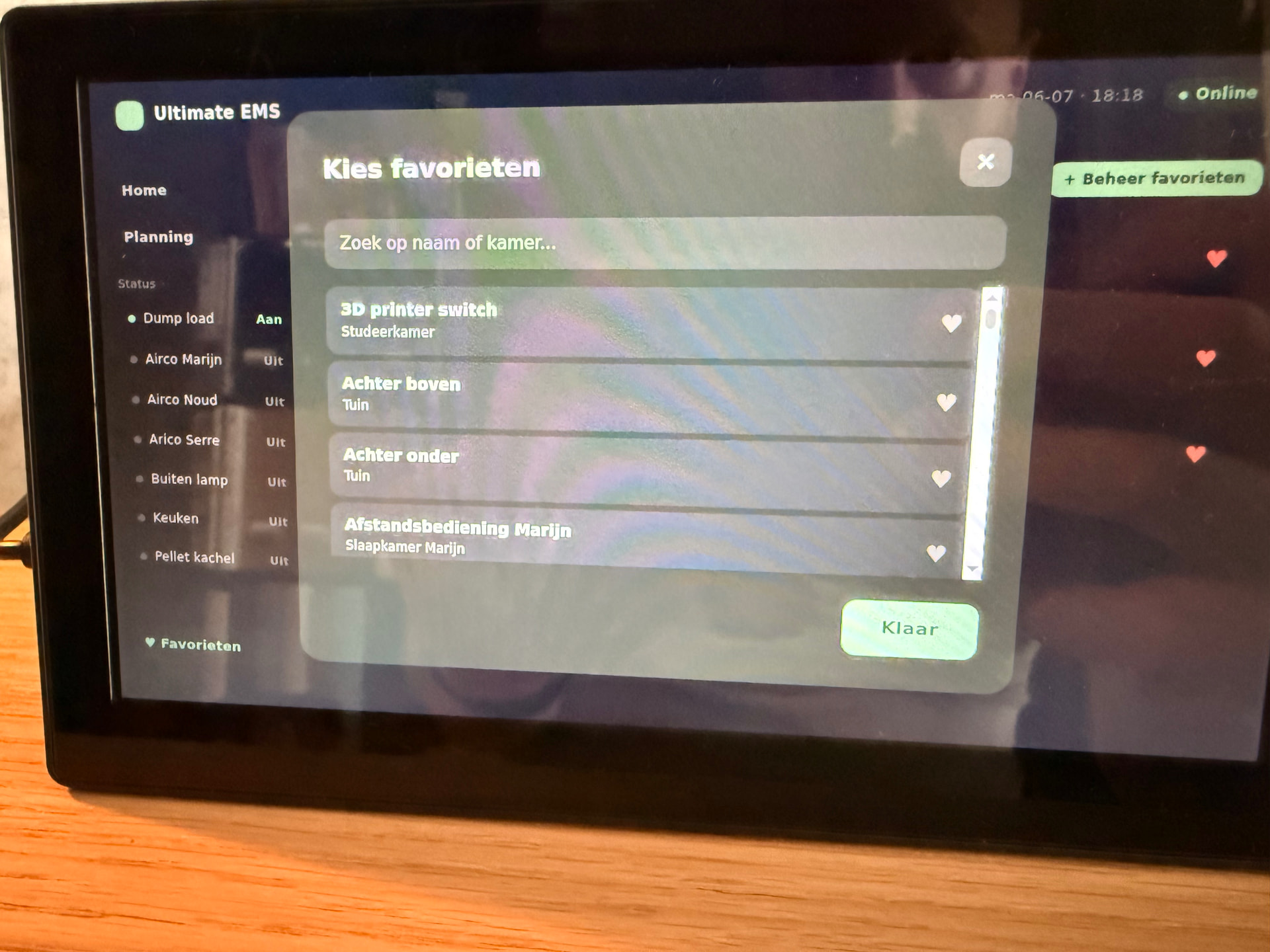

New feature that I’m working on…
Ultimate Homey EMS Touchscreen Display.
Any wishes from you guys?
done! Not all is translated but the majority should… please try it out…
