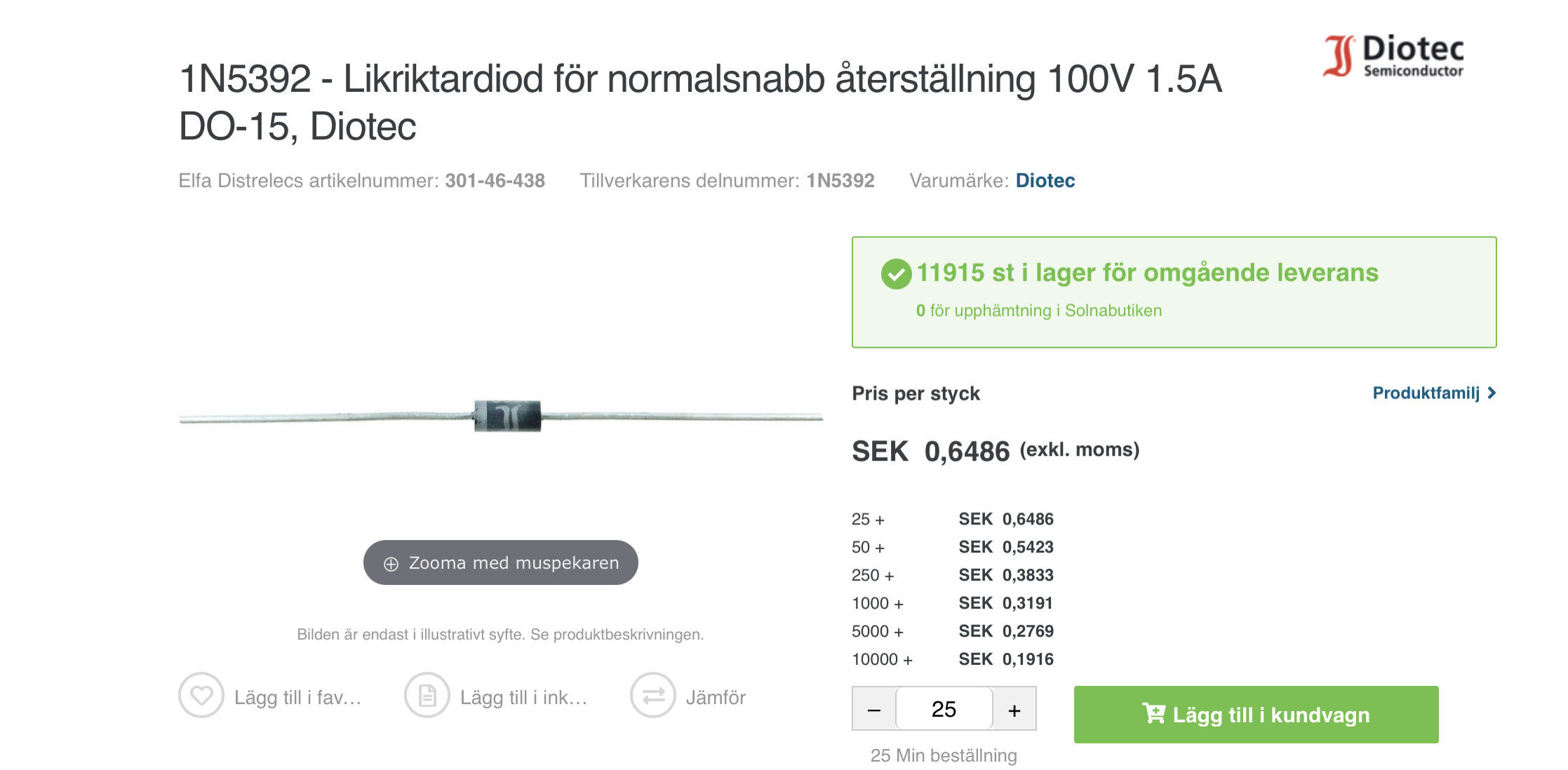

Maybe you can place 2 diodes, serial connected, in the + powerline to reduce the voltage for the Qubino, min. 1.5A diodes.
Will this work
Looks perfect, not sure how many you need for the right voltage drop, so you better order 5 pcs. Qubino max. Voltage is 24 + 10%.
The min amount to buy was 25
Will the lift work OK with 26.4 volt
Tell me if you have done the test, I don’t have this lift, but probably it will work, :face_with_raised_eyebrow:
but don’t use them all 25 :wink:
I solded 4 of the diods and got 26.8 volt
It works good
Thank you for all the help
