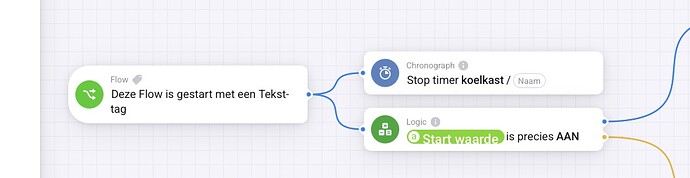

Try using ‘start flow with tag’ and ‘this flow was started with tag’
I’m not familiar with “tags”. Does that value have to be something meaningful or just an arbitrary text?
For easy understanding I chose as tag “AAN” and “UIT”
In this case flow ‘koeling AAN/UIT’ is started but also could be addressing itself.
