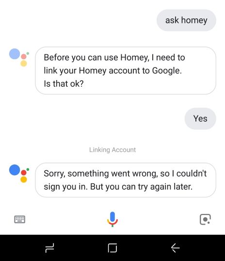

Is this problem related? I am pretty sure I had Homey work with Google Assistant earlier but it seems to have stopped working recently.
I just visited Googe support and there are at least 12 people experiencing the same problem but no answer yet. :disappointed:
