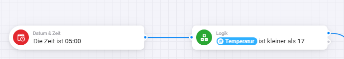

I want to to the last statement, But I cant seem to use the AND statement after the time. or I cant seem to use temperature after AND; how does that work?
Hi @Jeroen_Mo
Here is an example for normal flow:
Test Flow Time AND temperature
or as advanced flow
I don’t really understand your problem. In most properties from devices you need a Logica card “… is less than …” and the you search for your device and choose the #temperature property of this device.
If the issue is something else, show us, what you have and where the problem lies.
I did not understand the logic card usage. I was searcing to start with the device and then read the temperature. This helped me and I understand how this works now
