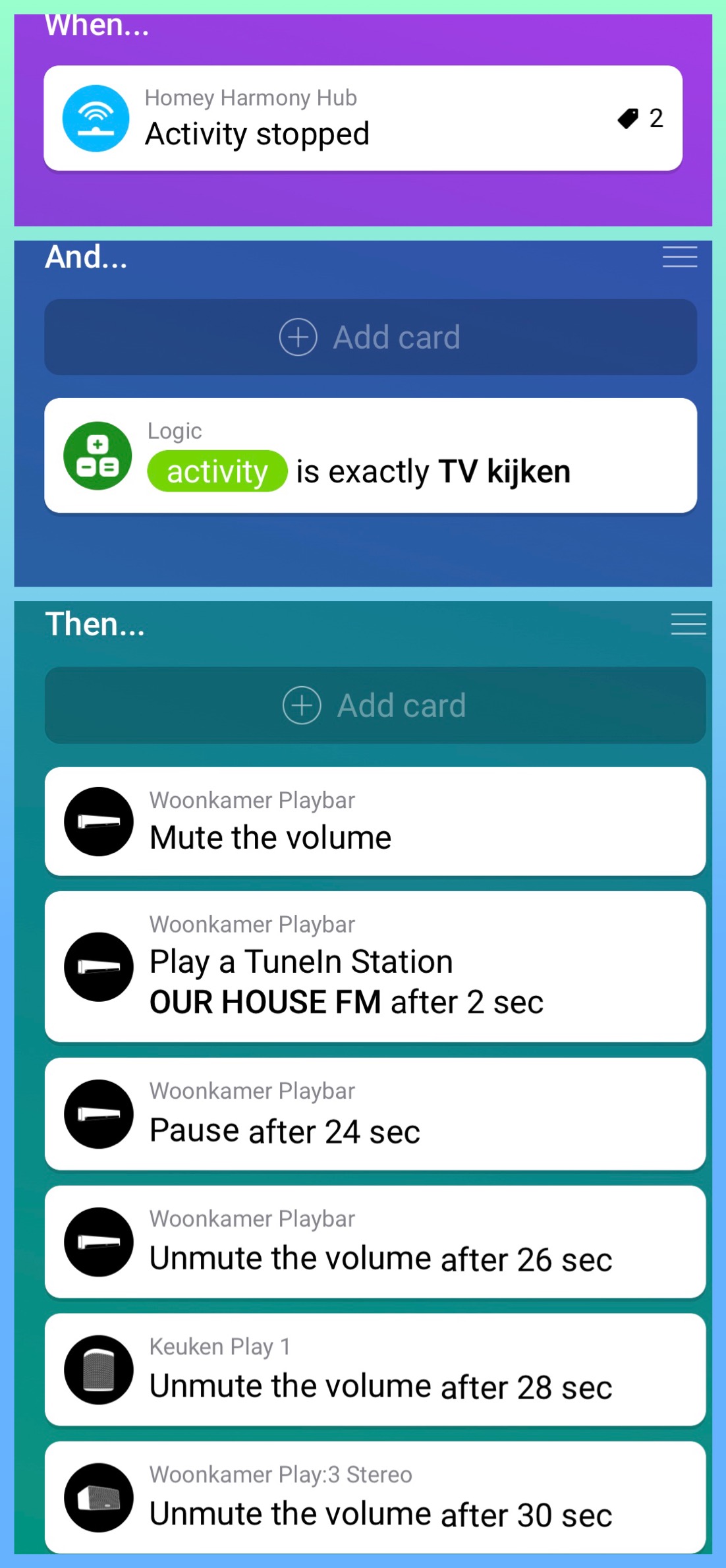

I use the harmony hub. It detects when activity is started or stopped. That way I control de sonos speakers, kichen speaker muted surround speaker muted, sonos play volume 15 etc. Stop tv watching, unmute, volume 8 sonos playbar etc etc. Works like a charm.

@Marcel_Ubels: I’m guessing AyrtoN doesn’t have a Harmony Hub. Buying one especially for this purpose might be a little bit much. If it were up to me, I would buy a wall plug instead. Cheaper and you can also use it for other things. The Hub probably has more options, that I don’t know.
