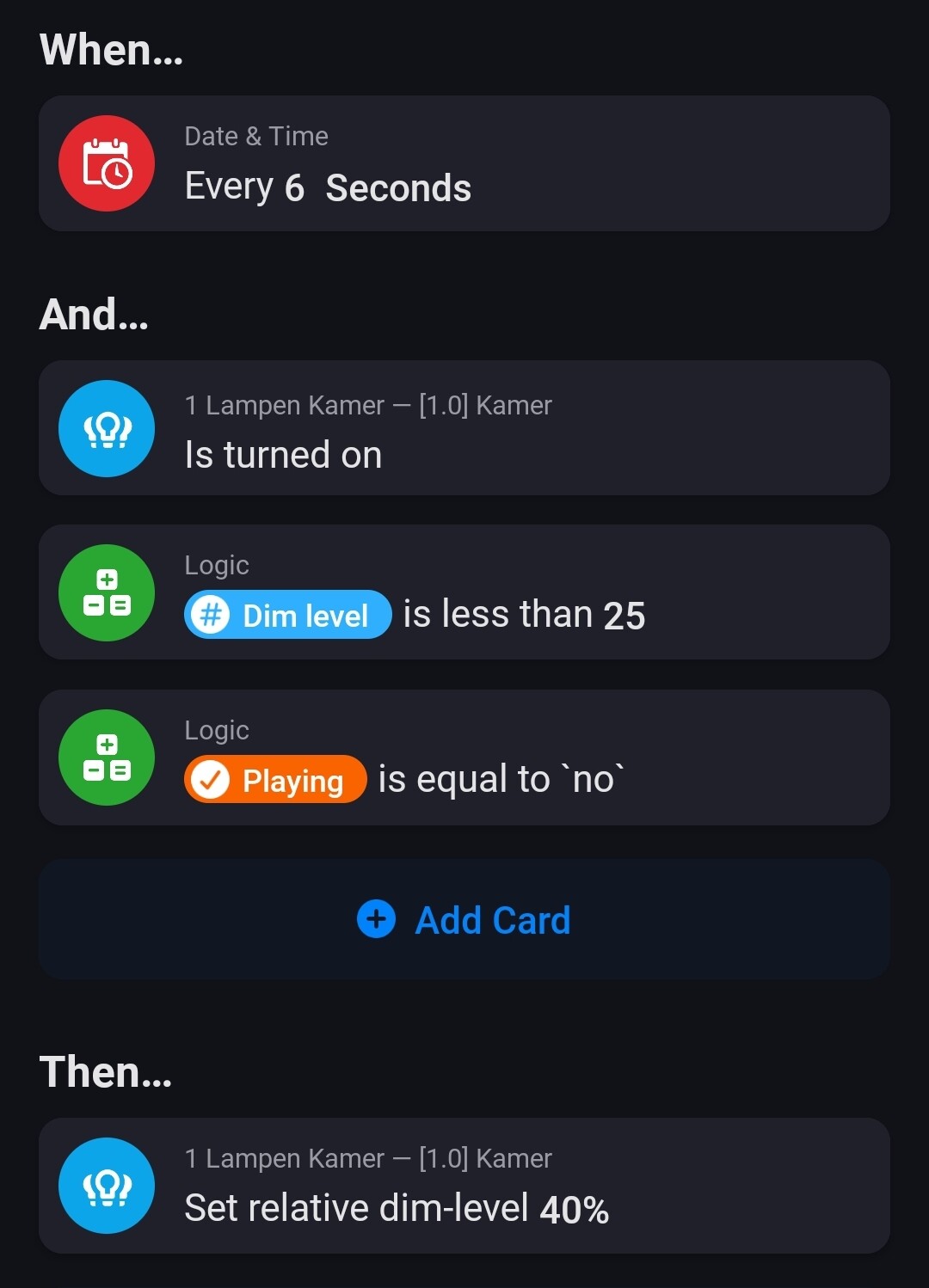

The Google TV app works well however, it does not have “Pause” in the when cards, I want to make a routine that brightens the light when YouTube or anything else is paused, then dim when unpaused. The only option I saw was “starts” or “stops”
You can use something like this as a rough workaround:
And you should add something like “And tv / media player is turned on”.
I’m assuming here a paused state means: the [Playing] tag is equal to false.
