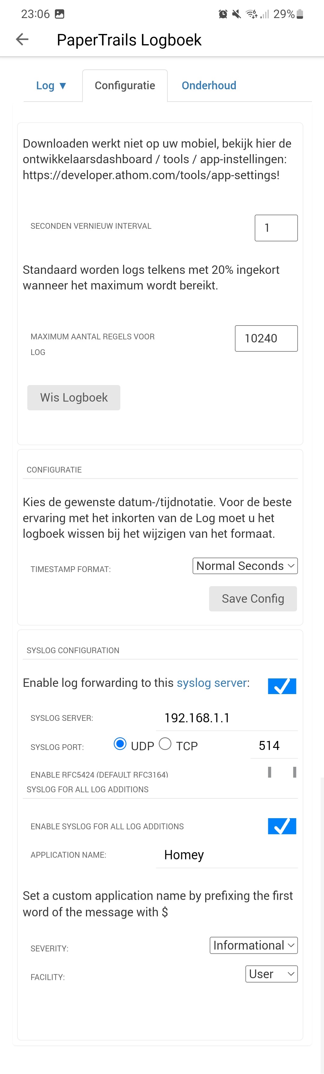

This is a screenshot of how the log looks like in the app settings:

Currently my settings are for 10240 entries and logs are cut off by 20% when the max lines is reached. In time, that comes down to about 2 months in my case. Current oldest entry is off dec. 19th.
The app uses 16.9MB memory and app size is 1.6 MB.

About 29 in that frame, but there’s a search (filter actually) function, see the screenshot above.
You can also scroll through the list (chronologically).
Any way to download it?
No, but the log entries can be sent to a syslog server. I never really used that part though.
