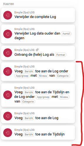

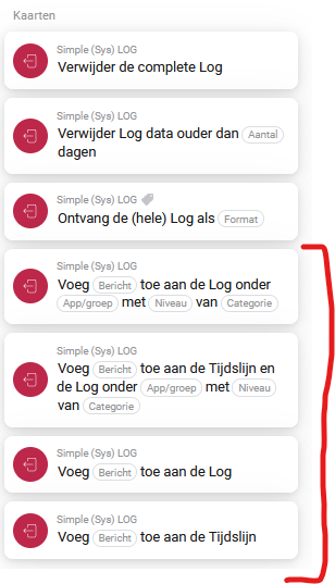

Okay, i have done it like this:
  • One card is now deprecated.
  • There is one simpel Log card.
  • There is one simpel Timeline card.
  • There is one advanced Log card with all optional fields (except timeline).
  • There is one advanced Log card with all optional fields with timeline.
