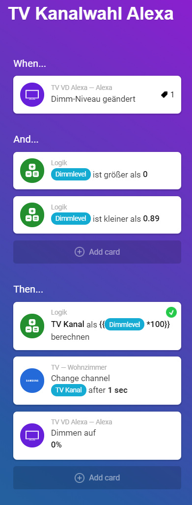

Here’s how I solved it. I didn’t want to create a virtual device for each channel. You configure a virtual device with dimm level. Each dimm level controls a channel:
Now you have to create an Alexa routine for each channel. “Alexa, CNN.” You use the routine to set the dimm level of the virtual device. The dimm level triggers the channel with the corresponding number.
But after that you should not change the order of the channels on the TV.

Hello, I solved that with one switch for every channel. So I can say “Alexa, RTL” and TV is switching to channel 3 which is RTL. Can also start Netflix and so on simular.
