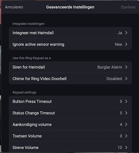

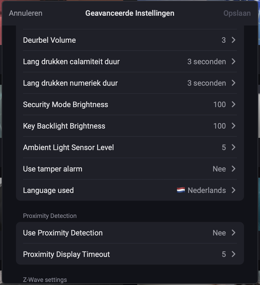

Who can help me with the following? As of today, I have added a Ring Keypad 2 to the alarm system I created using the fantastic app Heimdall. However, now that the Ring is added, a problem has arisen: when the alarm is triggered, the Keypad automatically deactivates the alarm.
The flow I created and the settings of the Ring app are as follows: see photos

@Benvo , when the alarm fires you activate and immediately deactivate the alarm, why would you do that. I think there is your problem.
