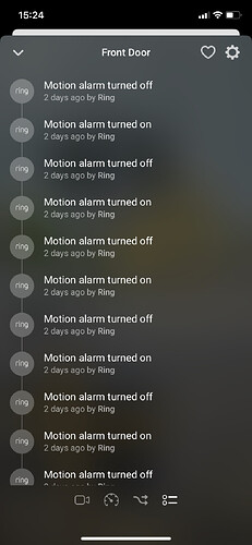

Just as an update to this one.
I tried to have the lights blinking too by removing the Date & Time card and the lights do not blink.
Basically this all flow does not work anymore and the reason why I hear Alexa is only because Alexa is connected to Ring via Alexa app and it is used as a chime to Ring…other than that nothing on this flow is working.
Apparently the Ring app stopped working 2 days ago as per screenshot and no other flow based on any other ring device i have at home works.
I have also already restarted both Homey and the Ring app several times and revocked and re-granted access to ring app.
The Ring devices in Homey all appear to be responsive but actually they do not work in flows.
Is someone able to help? Thanks
Unfortunately Ring has made a, for now unknown, change to how their API works.
Please read this post: Ring Doorbell and Camera support for Homey - #98 by DaneedeKruyff
The developers of the ring-client-api which the Ring Doorbell and Camera app for Homey uses, are aware and looking into creating a fix.
Ring offers no support for third party integrations, so it’s impossible to say when this is fixed.

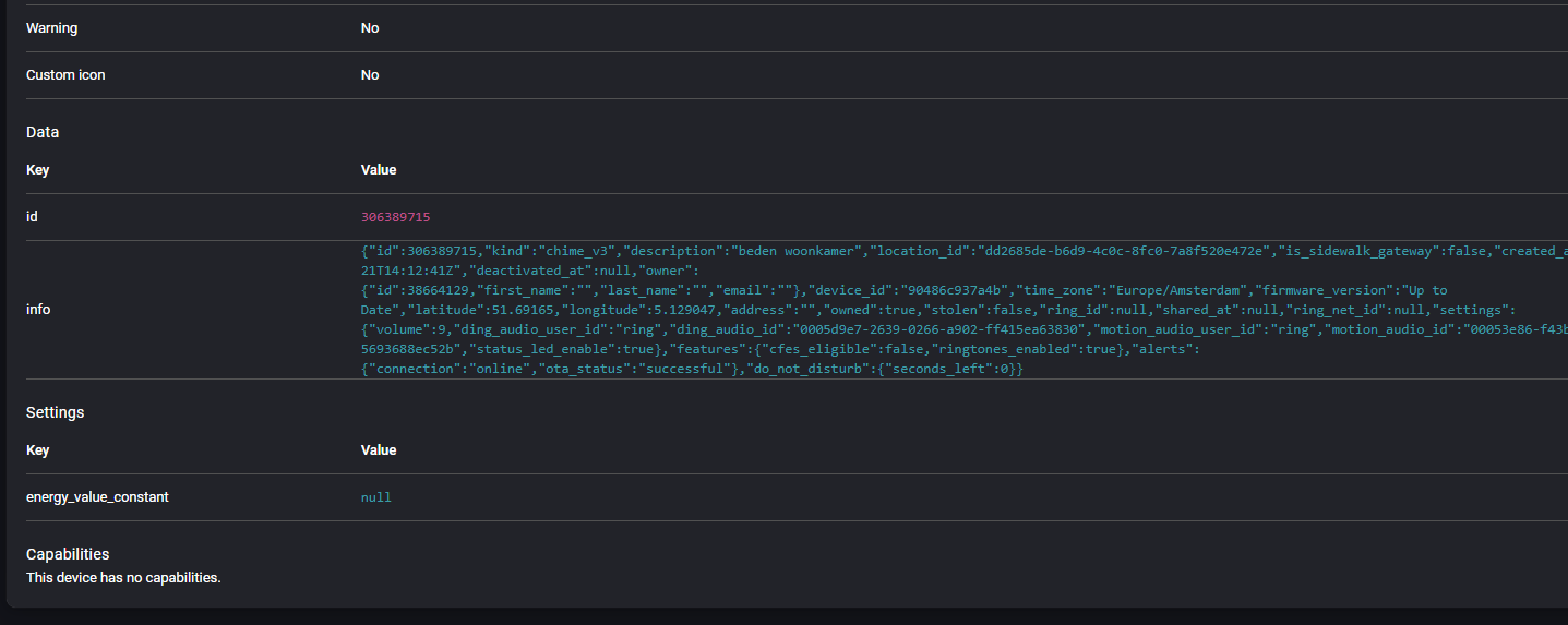

Hi there, I just recently bought a Ring Chime (2nd gen) to connect to homey, mainly to receive a sound notification when my Aqara door sensor is triggered. The flow card of play sound does not seem to work for the Chime.
I,m on the new Homey Pro (2023), is this a known issue and any possible fixes?
Device shows this: (This device has no capabilities)

I restarted the app and ran the flow below:
First got the network request failed and then another error showwing: “Object object”
Diagnostic report: 113b13b4-981a-4cbf-a0bb-f7a0441983d3
Hope might see an easy fix, if not enjoy your holiday and let me know afterwards please :sunglasses:
The “Object object” and “Network request failed” have nothing to do with the app, that’s just Homey’s web client, if you force refresh those errors will disappear. (At least for a while).
I can see nothing wrong in the log and that flow also looks fine to me so I’m not sure why it isn’t working for you. I’ve just tested it at my Homey and there it works.
