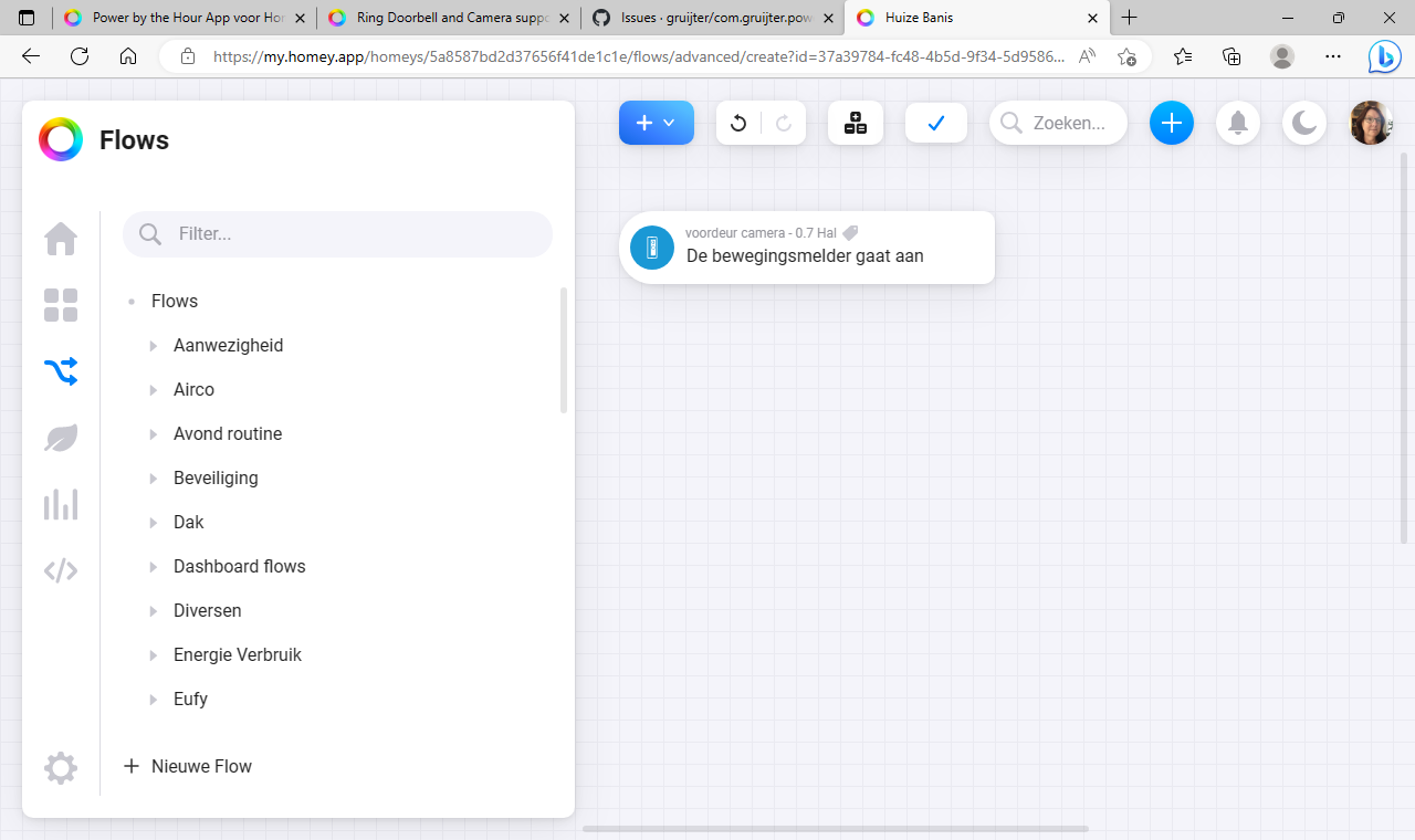

Hi Danee. I tested this but I don’t have the tag for the motion type. In the official Ring app package is recognized (smart alerts is enabled) (RingV2)

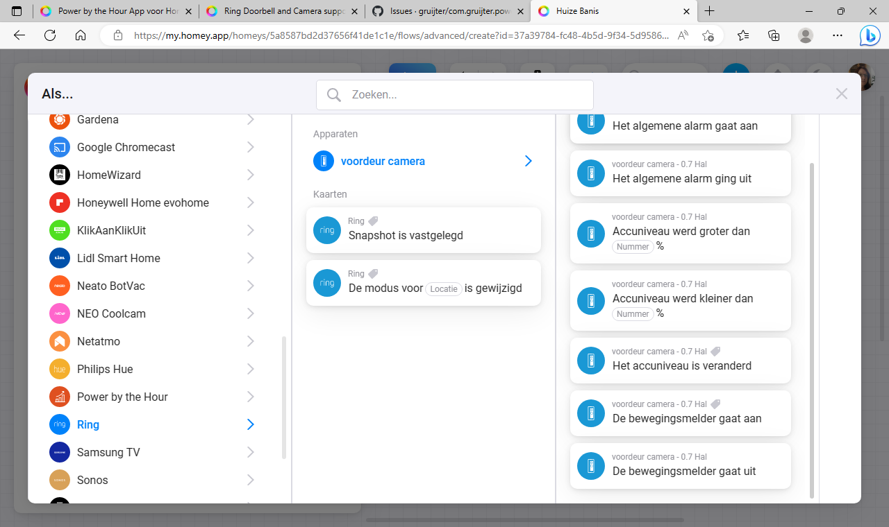

I’d be interested to see a screenshot from the cards overview when adding the flowcard from the web client.
Could you please go to my.homey.app, create a new flow, select Add Card in the When… column. Next select the Ring App in the left column and your Ring Doorbell in the middle column. No please make a screenshot like the one below.
I hope this helps.
Hi Ria,

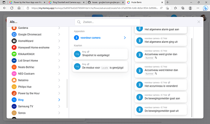

I see the tag in both the first and second screenshot (and obviously not in the third) so I don’t understand the problem.
Your second screenshot:
When in the advanced flow (from screenshot 2) add the logic card Text contains Text and connect the two cards. Next click on the left Text placeholder in the logic card, the available tags should appear:
