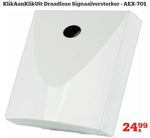

This should help (but a bit sad that it’s needed):
Update: Bought the thing. It’s capable of resending the signals of up to 6 KAKU senders (switches, sensors etc.), but it does this rather slow. About a second or two after a switch is pressed the signal is repeated. This makes that something like this:
turns the lamp on (by the switch itself (if the signal reaches Homey)), but a second later the lamp is turned off again (by the repeater).
