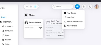

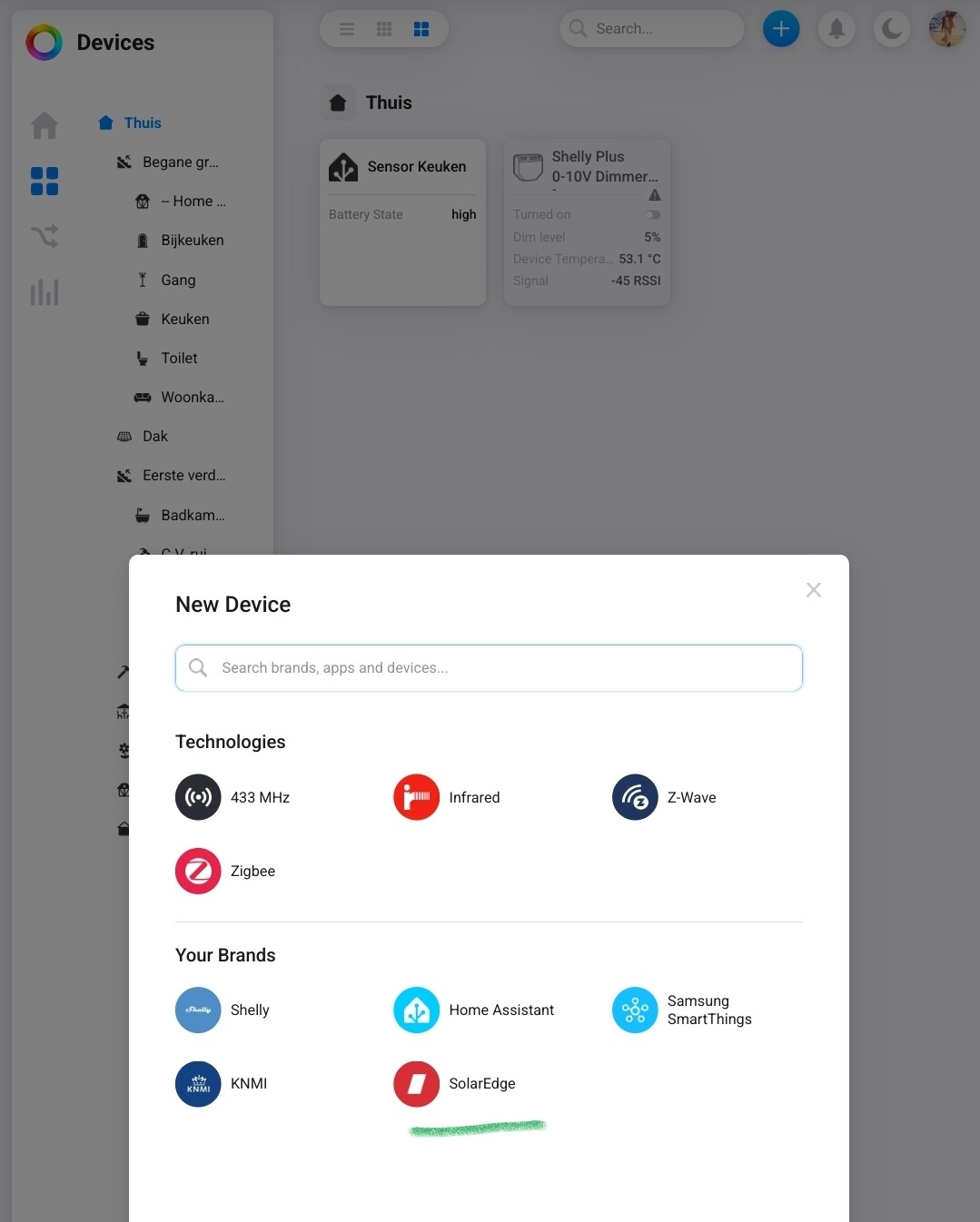

Did you install a Solar edge ‘device’ after installing the app? Otherwise there will be no flow cards.
In the app store you can preview the available standard flow cards,
but there’s no “Then” cards for the inverter
