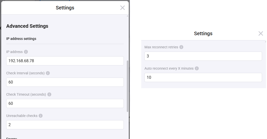

The Netscan ‘device’ is set up to check if the Remootio is online every 60 seconds, and the Remootio device is set up to try and reconnect 3 times (the max) every 10 minutes.
