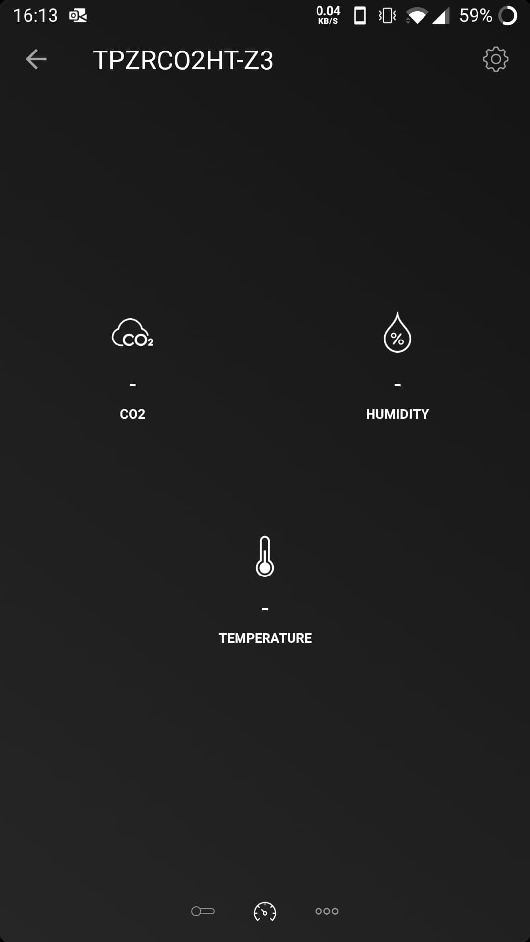

I’m trying to write a driver app for a Zigbee CO2, Humidity & Temperature sensor from Titan Products. To do so, I have used the homey meshdriver library. I have been able to connect to the sensor and get a Print of the clusters. But when I try to register the Capability to the cluster it does not display those values.
Custom Capability
"temperature": {
"type": "number",
"title": {
"en": "Temperature"
"uiComponent": "sensor",
"getable": true,
"setable": false,
"icon": "assets/temperature.svg"
In Device.js onMeshInit:
this.registerCapability("temperature", 'msTemperatureMeasurement', {
report: 'measuredValue',
reportParser: value => value / 1000,
get: 'measuredValue',
getParser: value => value / 1000,
Just to test I set up an attributeReportListener where I get the desired output:
this.registerAttrReportListener(
'measuredValue',
60,
300,
50,
this.onTemperatureMeasurementReport.bind(this))
.then(() => {
this.log('registered attr report listener');
.catch(err => {
this.error('failed to register attr report listener', err);
onTemperatureMeasurementReport(value){
this.log('Temperature: ', value / 100);
Output:
2020-07-07 11:45:37 [log] [ManagerDrivers] [co2th] [0] registerAttrReportListener() -> configured attr reporting attrReport_0_msTemperatureMeasurement_measuredValue
2020-07-07 11:45:37 [log] [ManagerDrivers] [co2th] [0] registered attr report listener
2020-07-07 11:47:37 [log] [ManagerDrivers] [co2th] [0] Temperature: 23.35
2020-07-07 11:48:37 [log] [ManagerDrivers] [co2th] [0] Temperature: 23.31
2020-07-07 11:50:37 [log] [ManagerDrivers] [co2th] [0] Temperature: 23.28
What might I be doing wrong?
