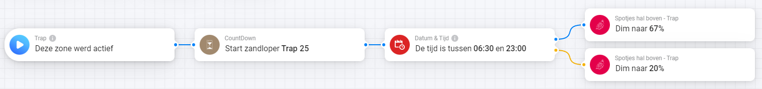

The flow is quite simple. When the sensor is activated it starts a countdown of (here) 25 seconds.
If the countdown reaches 0 another flow shuts down the lights.

Please try this flow:
(Sorry, only in German language!)
The time between Zone became active and Zone became inactive depends on the setting of the parameter Bewegingsdetectie AAN tijd (s). So if this parameter is set to 15 s, then you have to use a timer with 10 s. The result will be, that the light goes off after approx. 25 s after the last motion detection (that’s at least the theory :wink:).

Hi @DirkG ,
Your flow seems to work. Perfect! Thank you very much.
