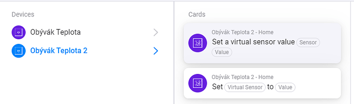

And could you make me prtscn of settings one of the row ? I mean:
Uff I really donยดt know what is wrong.

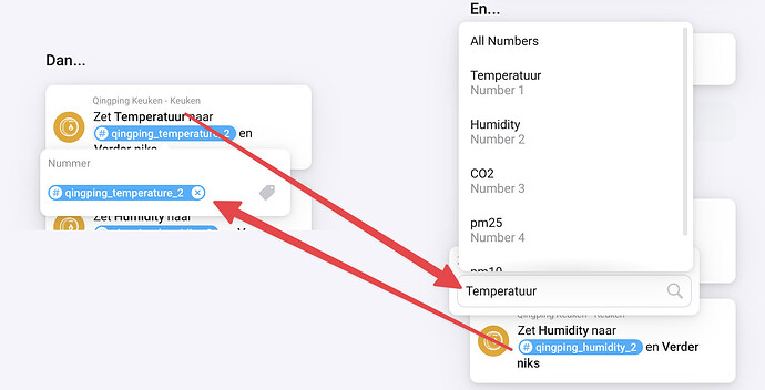

Just for sure into Then what exactly do you insert ? Because it looks like you choose 3 values. But I am able to choose only one + Value.
Is it correct ? Do you use the same cards?
Virtual devices / Device / Cards
Thank you very much for your help!
Ok I have it! :smile:
Whole issue was about value - the best way is tested into the flow.
You have to add value through this icon :grinning:

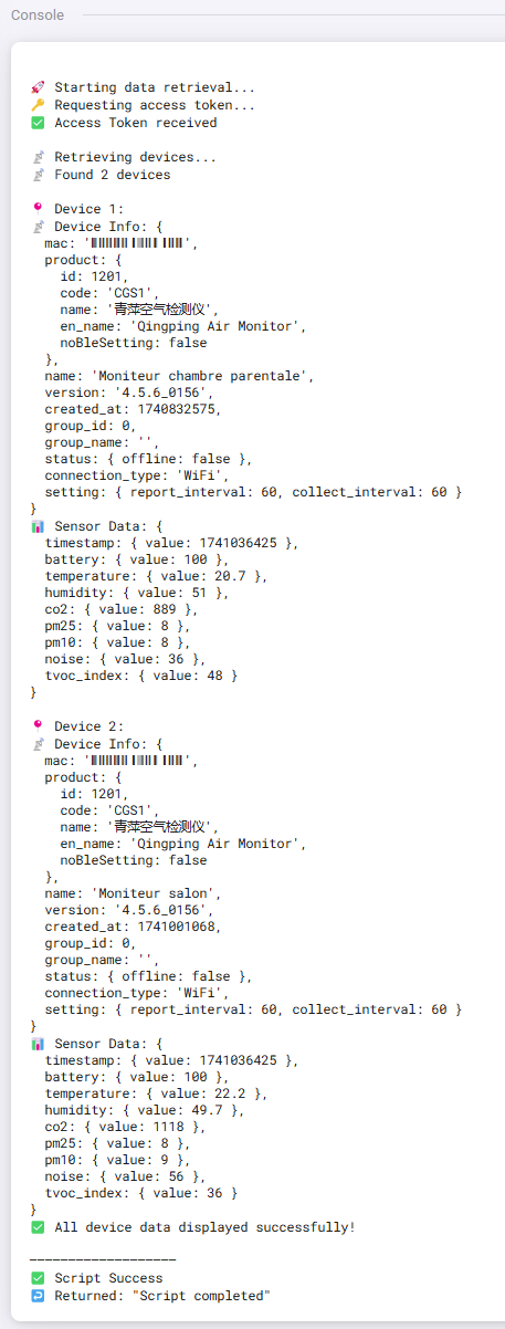

Once everything is set up, here is the result (the MAC address has been blurred):
Here is a V2 of my scripts.
This time, they dynamically retrieve all connected devices and process them one by one, using the MAC address as a unique identifier.

And the output:
Everything is working perfectly on my end :+1:
