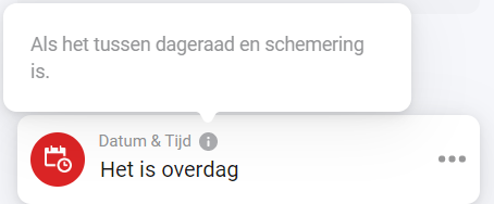

I have a flow with “during daytime”, which isn’t working. Tonight the flow still continues as ‘before sunset’, while it was already after sunset. The time on my Homey is correct and the variable ‘sunset’ is also correct. When I change ‘during daytime’ with 2 separate checks ‘after sunset’ and ‘before sunrise’ is works correctly. What could be the issue?

Pls share your flow.
I meant “during daytime”. Tonight at 19:00 h it followed the flow “true”, where it was already after sunset.
Have you read the Tip?
in dutch the Explanation: Schemering - Wikipedia
That’s very useless then… Thanks. To my option “schemering” ends when the sun has set. Then I need the light to turn on bright and not like it’s daylight… But I’ll try “During nighttime”, maybe that’s what I need.
