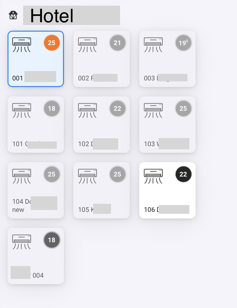

I own a hotel with 10 rooms, they all have airco’s in them connected to my Homey. I have several flows to changed the airco’s status. In the morning when the cleaning of the rooms start I put all the airco’s in Fan only with max fan capacity.
In winter time they all heat the rooms to a comfortable temperature before guests check in etc ect.
I would be very nice to have one panel with all the airco’s on them, and showing different colors based on the modus of the machines.
In homey it looks like this.
Would love to recreate on NSPANEL
Go in device info and make a screenshot of the capabilities availables, I add support for this device
Il could make possible, we need all values availability for the thermostat_mode capability
here they are
Ah ok, operation mode, normally is thermostat mode… I add it in next version
