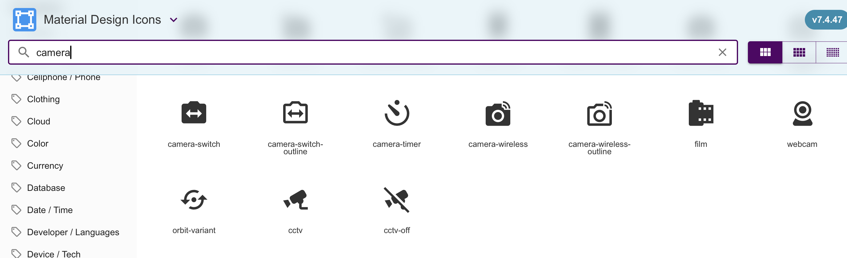

Tried to add cctv in the custom but after saving the icon is not displayed. After reopening the panel settings the custom icon files is emptied out
you’re right, I didn’t load all the changes in the panel section, only in the widgets.
I fix soon
v 0.240311.4
  • Fixed custom icon in panel
