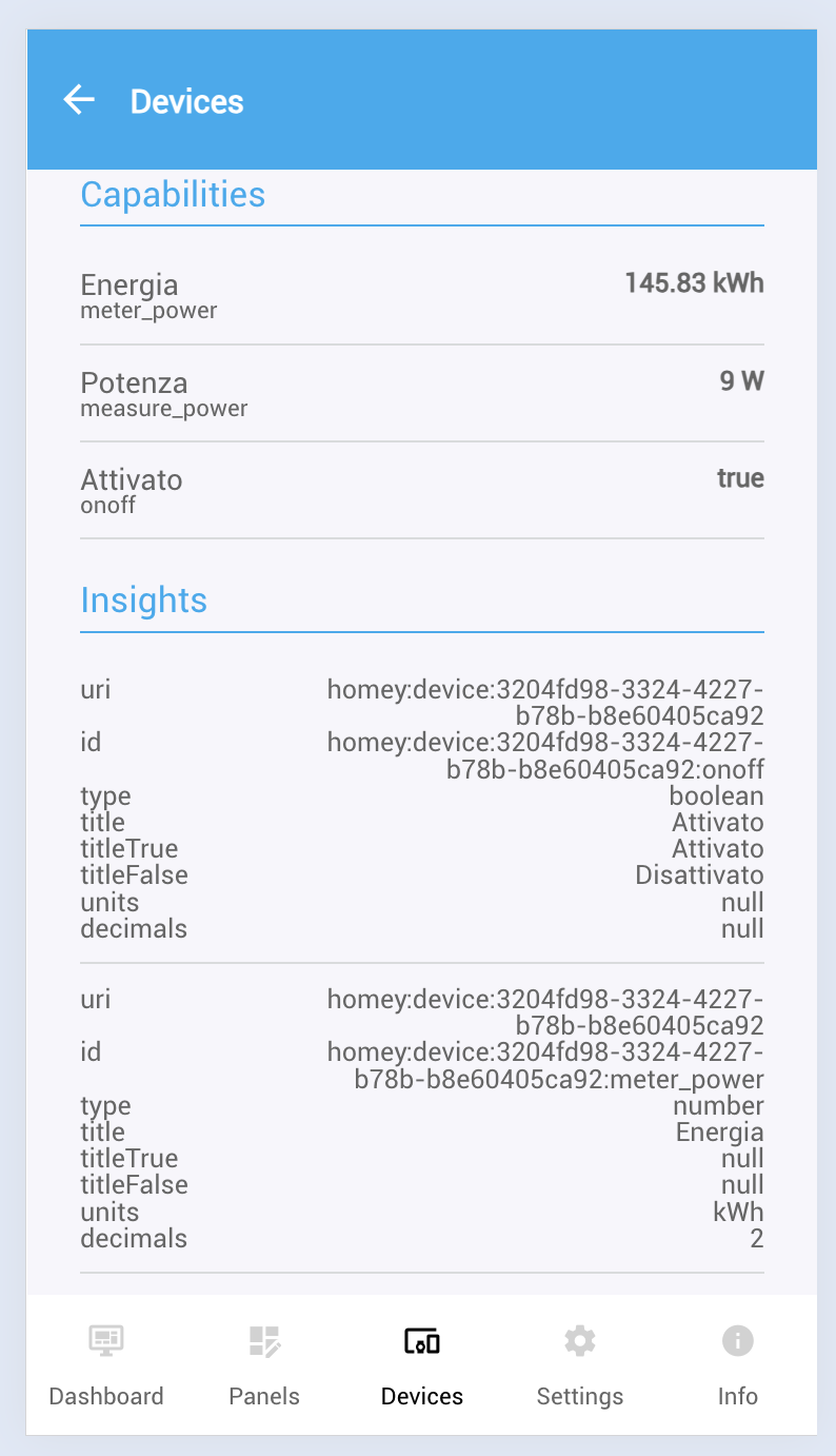

in devices i haven’t any insight avaible.
and when i try to put insight i have a msg : Warning - null
you have checked on multiple devices?
no just one
ok, check many types. What is your smarphone? Android or Ios (Ios version is coming in apple store)?
i have the dash on android and on nspanel
Ah OK! With nspanel is more simple make testing.
Tomorrow i try to release a test app for checking some things
ok perfect

I release an update, for nspanel, after install, go in a devices, select a device and check if now the insights infos are present. Example:

Hello
I don’t see any insight info in devices
Sorry
