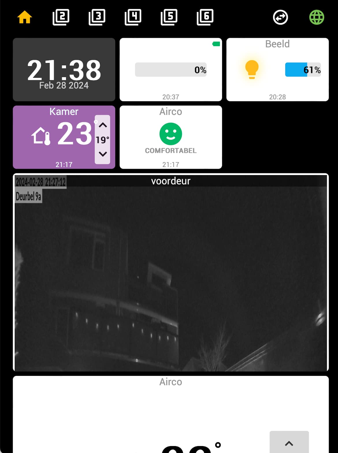

Hi there. I love the dashboard app. My NSPANEL is on the way. So I am testing on iOS for the moment.
One thing I want is a snapshot from my doorbell when the doorbell rings.
I did add a Virtual Camera with a refresh time of 1 minute.
For now I do get an images out of my Unifi Doorbell (https://ipadress/snap.jpeg) but:
  • it is not sized correctly in the dashboard. See screenshot.
  • It is not refreshed every minute. (see screen shot time vs time on image)
  • can you add a mechanism that the picture is updated when the status of the doorbell is ‘ringing’ ? Or by touching the image the image will be updated regardless to timer. So when the doorbell rings I can see directly (after touch) who is there. In stead of having to wait to the image is refreshed by the interval.

Hi, i fixed camera widget with ability to refresh image with a click.
v 0.240229.1
  • Addded ability to refresh widget camera with a click. Fixed image layout and added update time @WillemG
:pray: I didn’t expect an answer this quick :wink: Thank you so much.
I updated my iOS app to test.
Unfortunatly the result is better, but not 100% yet. see screenshot:
EDIT: GENERAL SETTINGS ->DASHBOARD GRID SIZE does impact the way the image is displayed. So I think it has to do something with that
  • Current time is 11:24 (see clock), updated time is 11:24 (in the deurbel box), but it did not reload the image. (see time stamp in left upper corner 11:22). I did double check both clocks and they are in sync

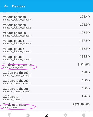

For SolarEdge sunpanel the wrong label is displayed.
DAILY PRODUCTION ↔ TOTAL PRODUCTION
Dag opbrengst is 2.43 see screen shot
Total production is 6876,91
OK,
For boxing is a test, in next version i re-add full viewing.
For not updating i think if a caching problem, in next version i add a workaround:
Can you try if in browser this call work?
https://ipadress/snap.jpeg?t=123456789
Can you see the capability name in the device info?
Drop here your ideas😊

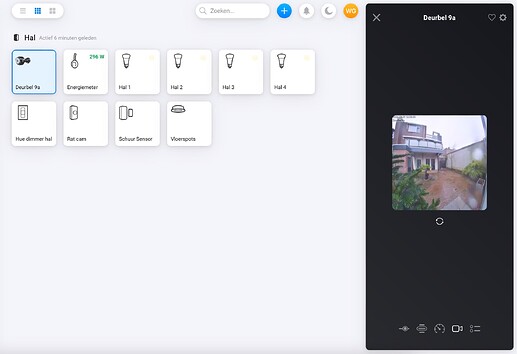

The call works.
I am wondering though why you read the pictures direct from camera, outside of homey. Isn’t there an API call to homey to get the image?
Becauase every camera has a different call. Homey should have a general call.
yes:
ok, in fronius app meter_power is daily value. Need to add a check for meter_power_daily exists
