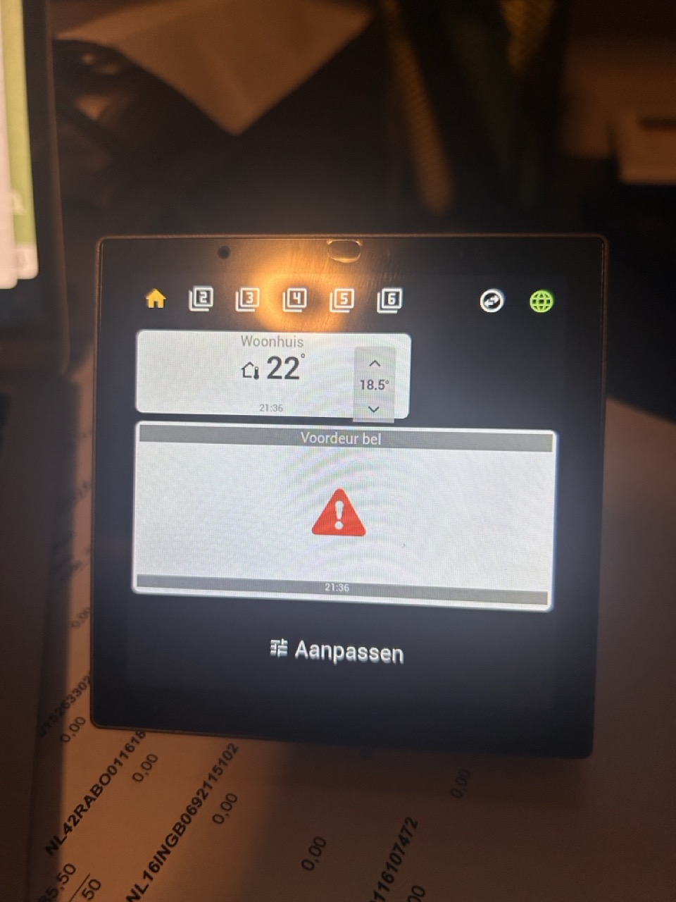

I got my NSPanel today. The virtual webcam shows Warning sign. (see screenshot)

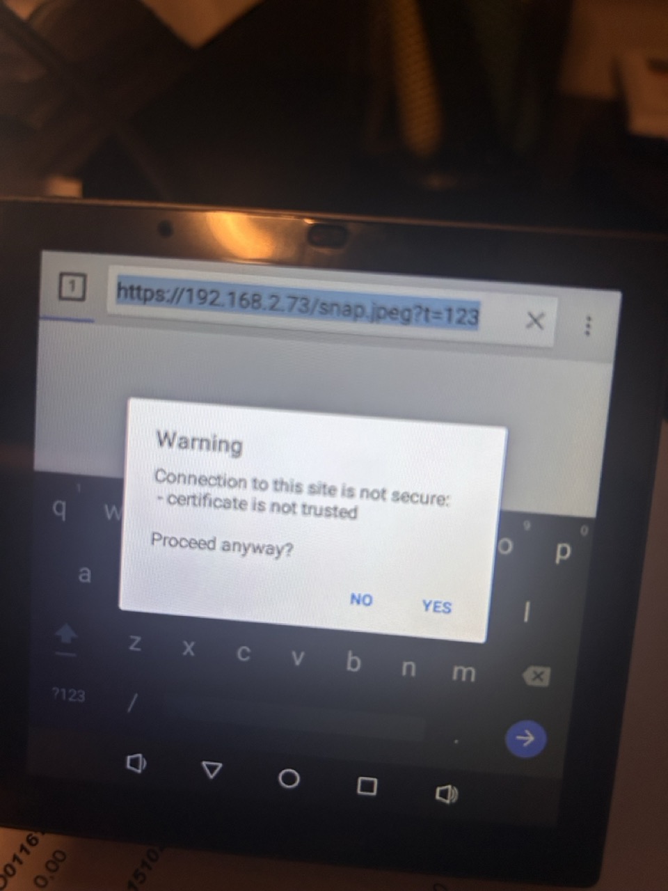

When I call the webcam from the browser it gives me the certificate warning. so probably that is in the way. Can’t think of a way to work around this. (I tried both http and https)

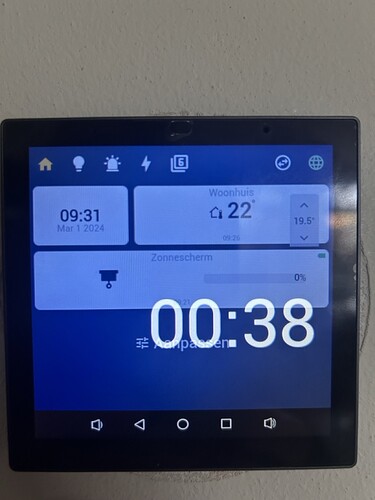

Screensaver is not activated on my NSPANEL. What can be the cause?
I have added CLOCK as slide 1 with a time out of 5 minutes.
MMM, i tried and seam work. check if slide 2 and 3 if disabled!
in widget options try to reduce font size
can you try with a public image for testing if it work?
When I input a jpeg file on any public website the image is shown correctly
that did it !
