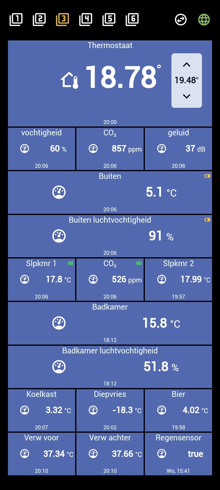

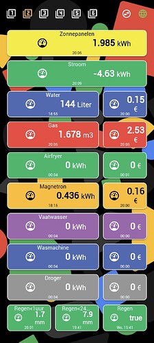

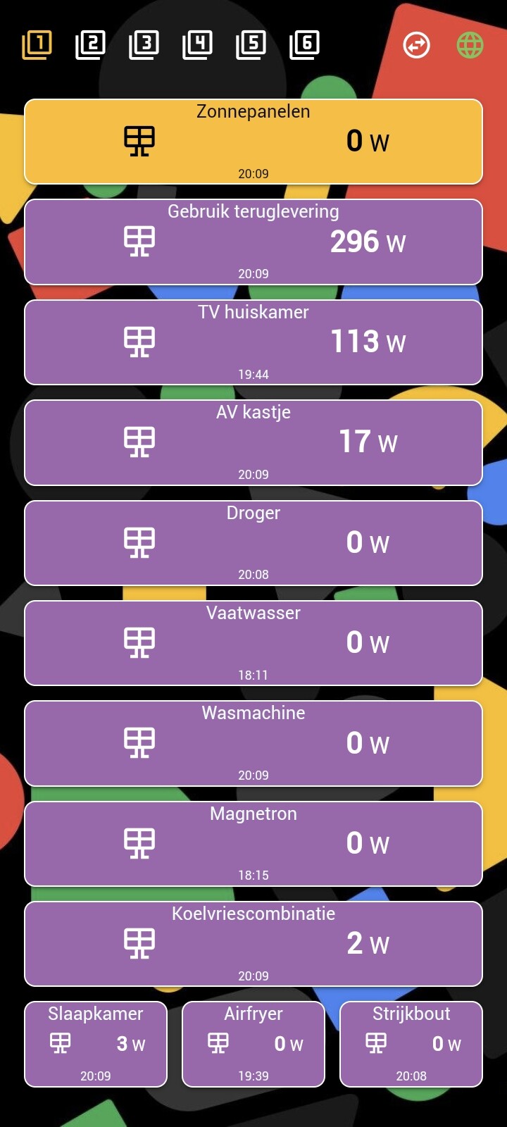

Hey, first let me say that SmartDash is a very nice dashboard. Good options for monitoring and operating. I would like to look for some inspiration to spruce up my dashboard, anyone who posts something nice.
Wow, very nice use :+1::+1::+1:
