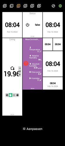

Hi, works fine!
Two Little remarks: next row allways starts at the bottom of the highest Field, so you cań t put 1x1 beside a 1x2.
And is ist possible to place the #settings under the page to hide it from users?

For the first is not simple make it automatically (i tried but i don’t find a definitive solution): a solution is with manual position of widget.
I’ll try again, maybe I’ll find a good solution!
Not ideal, but when you keep the “longer” widgets to the left you don’t get holes in your dashboard.

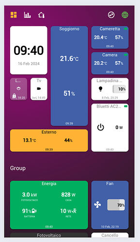

i’m find a solution:
CASE 1: current grid system
CASE 1: alternative grid system:
CASE 2: current grid system
CASE 2: alternative grid system:
The new grid don’t leaves empty spaces.
To recreate the previous version i need to insert a dummy widget for filling empty spaces
v 0.240216.1
  • Added new dashboard grid system @Thilo check this
  • Added dummy widget for fill empty spaces
