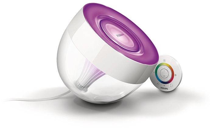

Depends on the version indeed. Easiest way to check is if you still know what remote it came with intially. Only the earliest models talk a different protocol. Based on the picture you can verify if it talks zigbee or not but looking at the link you posted I am afraid that you are out of luck.
Some of the later livingColors with the v1 remote were actually v2 devices.
This is what I had, but yes generally speaking you are correct with a tiny exception.
