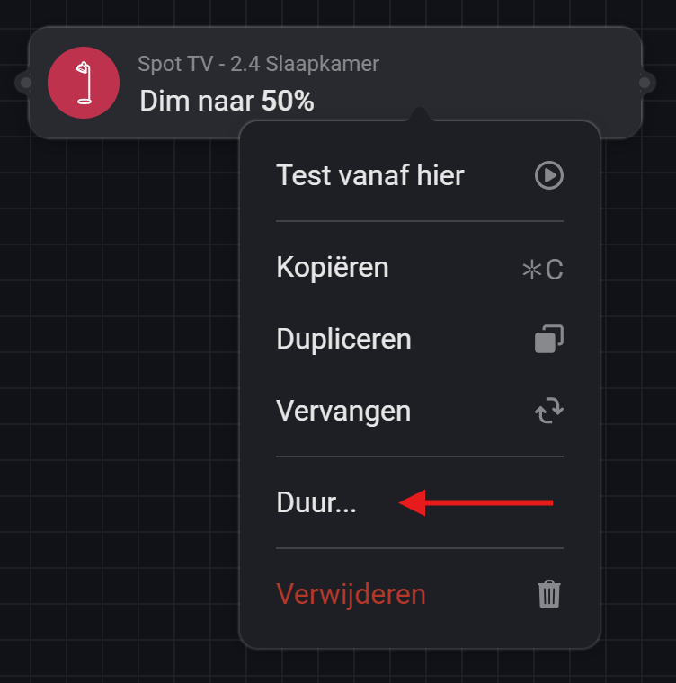

Often the flowcard that you use for setting the dim level has an additional ‘duration’ option that you can enable. I assume this is also the case for Philips Hue lights.
In Advanced Flow, you right click on the flowcard. You’ll see an option to add a duration.

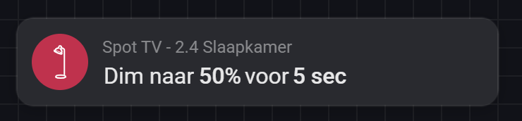

As an example, a duration of 5 seconds:

I don’t have the duration option in my context menu.
I’m using these lights with the Hue hub… is that the reason why I’m not seeing it?
Hi , I using also the hue Hub & it works . You must select the card “ DIM to “ than select Duur
