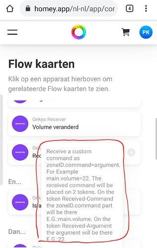

I don’t know if you tried the custom command?
Maybe something like main.input=tv
