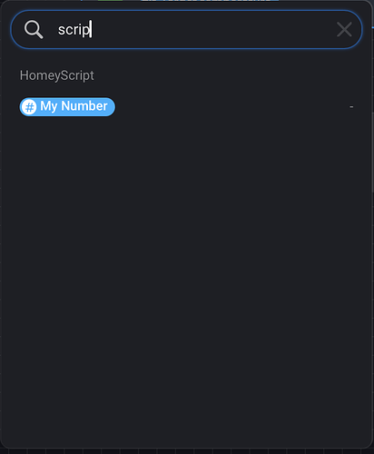

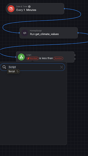

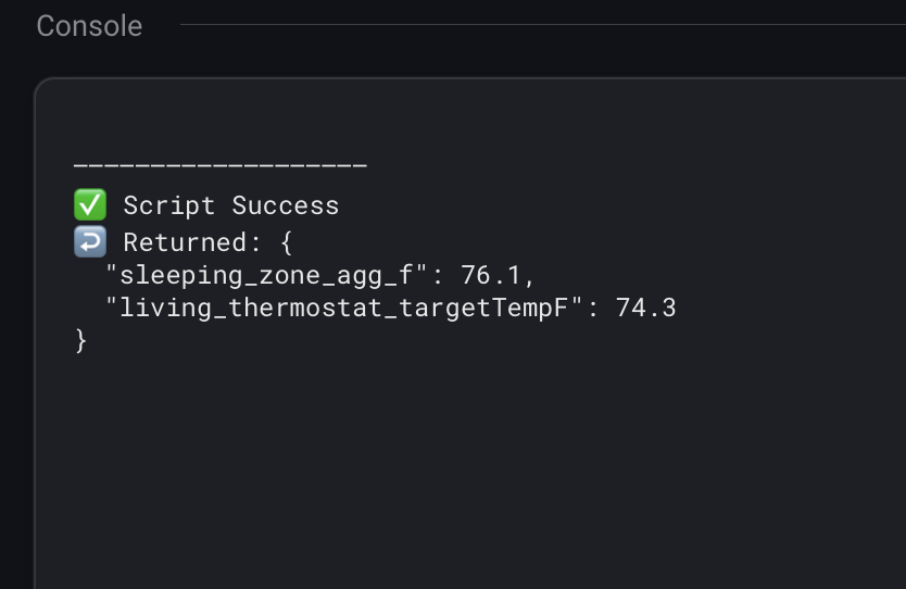

I was hoping to get some help here. I have a homey script that returns a large json object and attempts to set a tag for it. The return value looks perfect. And indeed the tag appears under the API endpoint when I request flowTokens via http. However, the Advanced Flow doesnt even show it as an available tag. Anyone know what I might be doing incorrectly?

interestingly they do appear when use “run code” and return as text. then it allows me to see the tags in another step, but not when I use the “run script”
