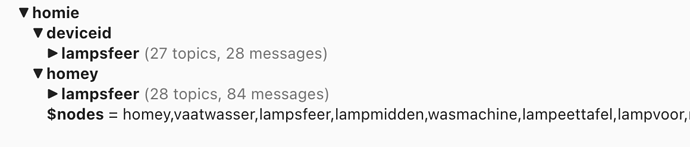

I have a problem that my sensors are not updated, when I look with the mqtt explorer at the broker, updates seems to be received but the same value is received. I restarted the client and hub many times already, all devices are selected from the hub app.
20210409-08:37:09 received ‘61’ on ‘homie/homey/airco-zolder/se-last-seen-seconds’
20210409-08:37:09 Trigger generic card for homie/homey/airco-zolder/se-last-seen-seconds
20210409-08:37:09 send message to listeners via realtime api
20210409-08:37:09 homie/homey/airco-zolder/se-last-seen-seconds: 61
20210409-08:37:15 SendMessageToTopic called
20210409-08:37:15 SendMessageToTopic: {“qos”:0,“retain”:“1”,“mqttTopic”:“homie/homey/pompvloerverwarming/measure-voltage”,“mqttMessage”:230.09}
20210409-08:37:15 publish_options: {“qos”:0,“retain”:true}
20210409-08:37:15 send 230.09 on topic homie/homey/pompvloerverwarming/measure-voltage
20210409-08:37:15 OnMessage called
20210409-08:37:15 received ‘230.09’ on ‘homie/homey/pompvloerverwarming/measure-voltage’
20210409-08:37:15 Trigger generic card for homie/homey/pompvloerverwarming/measure-voltage
edit:
I think I solved part of the issue my self;
screenshot of mqtt explorer, I was using topics from the deviceid section
