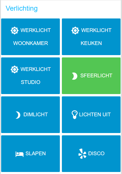

I’ve something similar with my light scene’s. When I select the scene that scene gets active by turning green. The rest goes back to blue:
I do it like this:
First of all, you need to let Node-red know that a new scene is selected:
In Node-red the MQTT, every button is connected to a function node:
The function node determends if the button behind the node is selected. If so, it makes the background variable in the payload green. Otherwise blue:
var color;
var color;
if(msg.payload === "Sfeerlicht"){
// state is true (lets make button green)
 color = "#53c653";
else{
    // state is false (lets make button blue)
 color = "#0094ce";
msg = {background:color};
return msg;
Inside the button, you need to set the background to the color variable:
ButtonColorsLightSetColor
