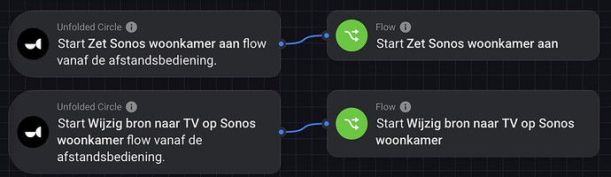

If you use Advanced Flows it should work, e.g.:
I have tried both and neither worked so far. Looking at your diagram it looks like you are triggering a flow from a flow. Is that also required or just a personal choice?

I use the remote to start existing flows. But of course, you could connect any flowcard that you want to execute to the Unfolded Circle’s WHEN card.
What matters is that the Unfolded Circle’s WHEN card is required in order to make the flow available on the remote. I noticed that it sometimes takes 10 minutes before you see the flow in the Homey integration on the remote. What may help speed up things is to restart the Unfolded Circle app on Homey.

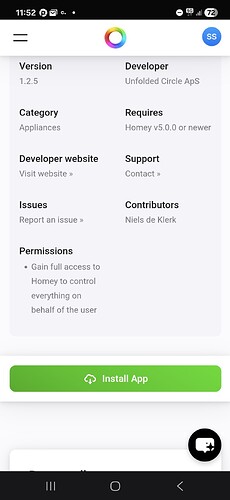

Then there is something wrong with the app. I checked it online and it shows this:
The permission means that the app can request device and Flow information from Homey and then it will likely check the triggers that way. Either it’s not requesting the Flows correctly from Homey or it isn’t forwarding them to the remote.
