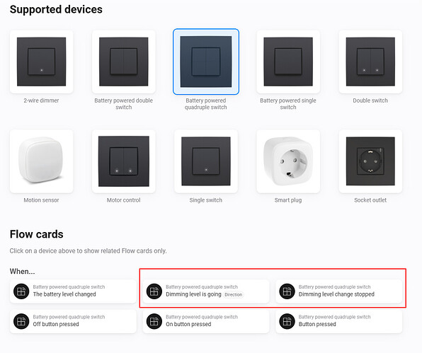

I still have 1 possibility. Do you use this via the Philips Hue app?
(attachments)
Hi, sorry for my bad explanation and my bad english… it’s not my mother language.
With this device Niko friends of hue
It’s without battery or power supplies !
with this, in homey, you only have the card “button clicked” and so it’s not possible to dim device. However, it can be add in the Hue app (without Homey) and in this case, you can dim devices but only devices available in the Hue App.
However !
You can use this device Niko zigbee
and this device can be add in homey with the application Niko Zigbee
and with this device/app, you can do all what you want in Homey.
I hope this 'll help you
