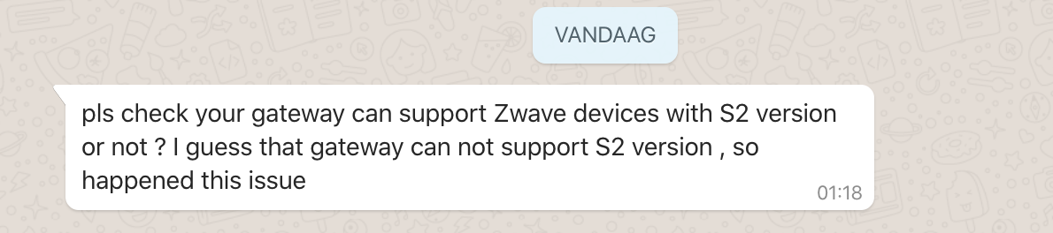

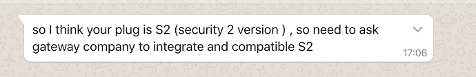

I had a chat with Neo… Does not seem like they offer a solution
I can’t find anything on S2 on Homey. Someone from Athom that can respond to this?
They keep trying to blame homey (Athom) while issue is on multiple platforms . So the issue is with them … they need to solve it
we have test it with other hub,haven’t found out the problem.but we know from customers that Homey ,Domoticz,Toon hub ect have the problem.it happen because we update it to be new version.but some hubs may not fully compatiable with it.
if anyone who use smartthings,Fibaro have the problem,please tell us,we will check.
As we just have Fabaro,Vera hub.don’t have Homey,Toon,and can’t use Domoticz in China.so we can’t test.
