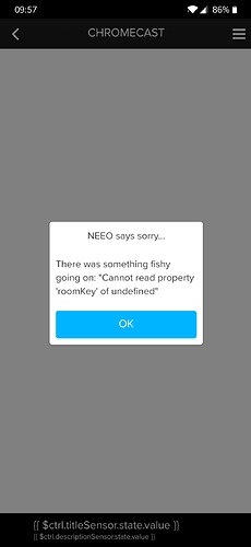

Also, have been trying to add a volume slider to my Chromecast, but this results in an error when activating the recipe, see screenshot below
not possible to add color wheel, only a slider that adjust color is in the firmware.
I have exposed all features available to NEEO. A colorweel isn’t in the NEEO code.
The issue you showed isn’t something I can explain and looks to be in the NEEO side. It seems like the NEEO thinks it is a player device and to support a player widget more components are required. I advise to test with a separate virtual device just for your slider.
