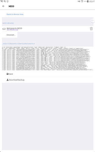

Hi @Niels
I have problem, when i press download backup in your app, homey app crashed and closed. Its android tablet, can you please look into this. Thanks
Sorry that’s know, I could remove the button but fixing it I cannot.
If you use developers.athom.com you can go to the app settings and download it on your computer.
Ok, Thanks @Niels.
