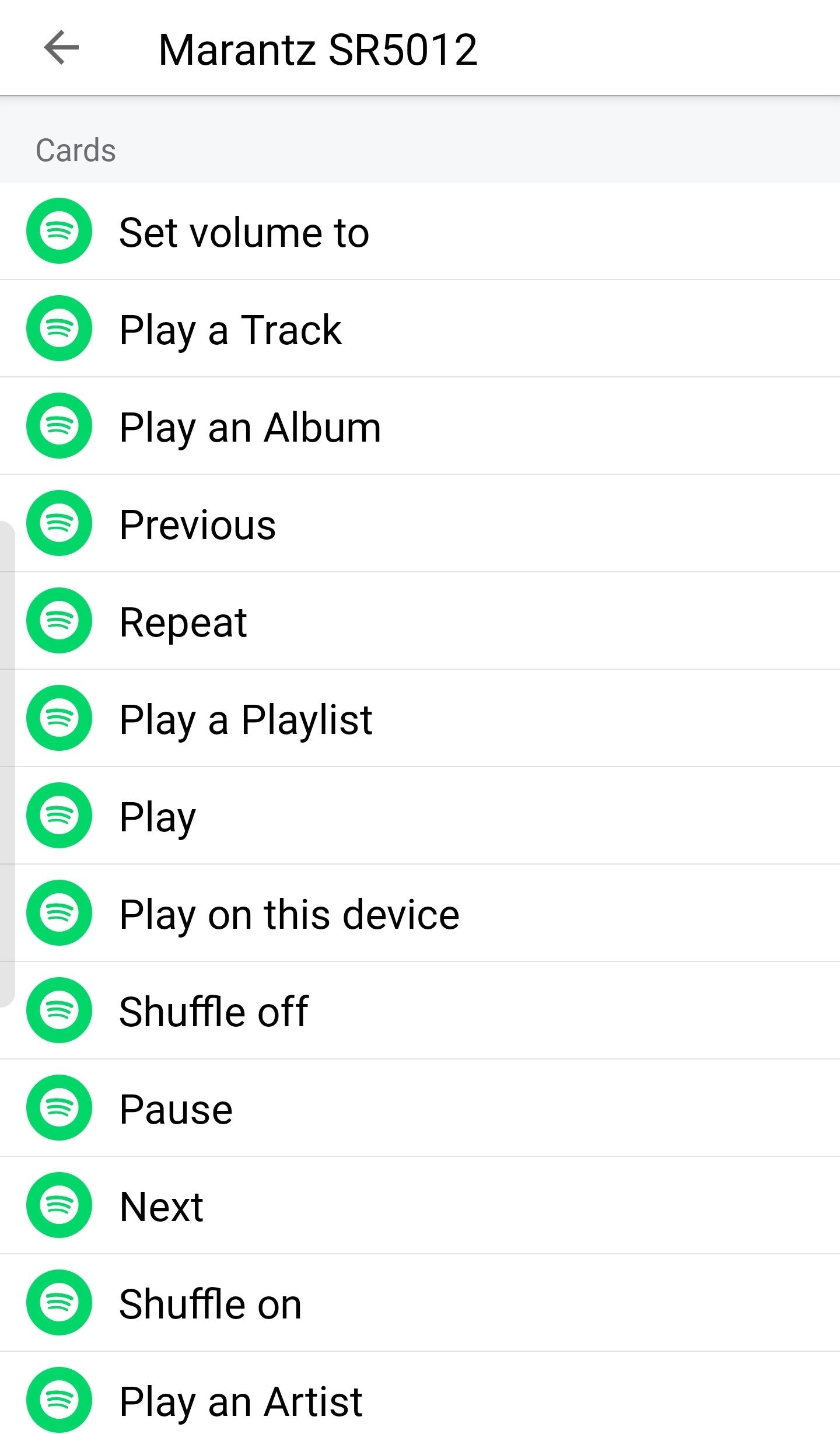

As far as I know you can play Spotify to 1 Spotify Connect enabled device at a time.
But I only have one, so I can’t test
I can’t play Spotify to Chromecast devices direct from Homey.
These are the possibilities for my Spotify Connect enabled receiver:
