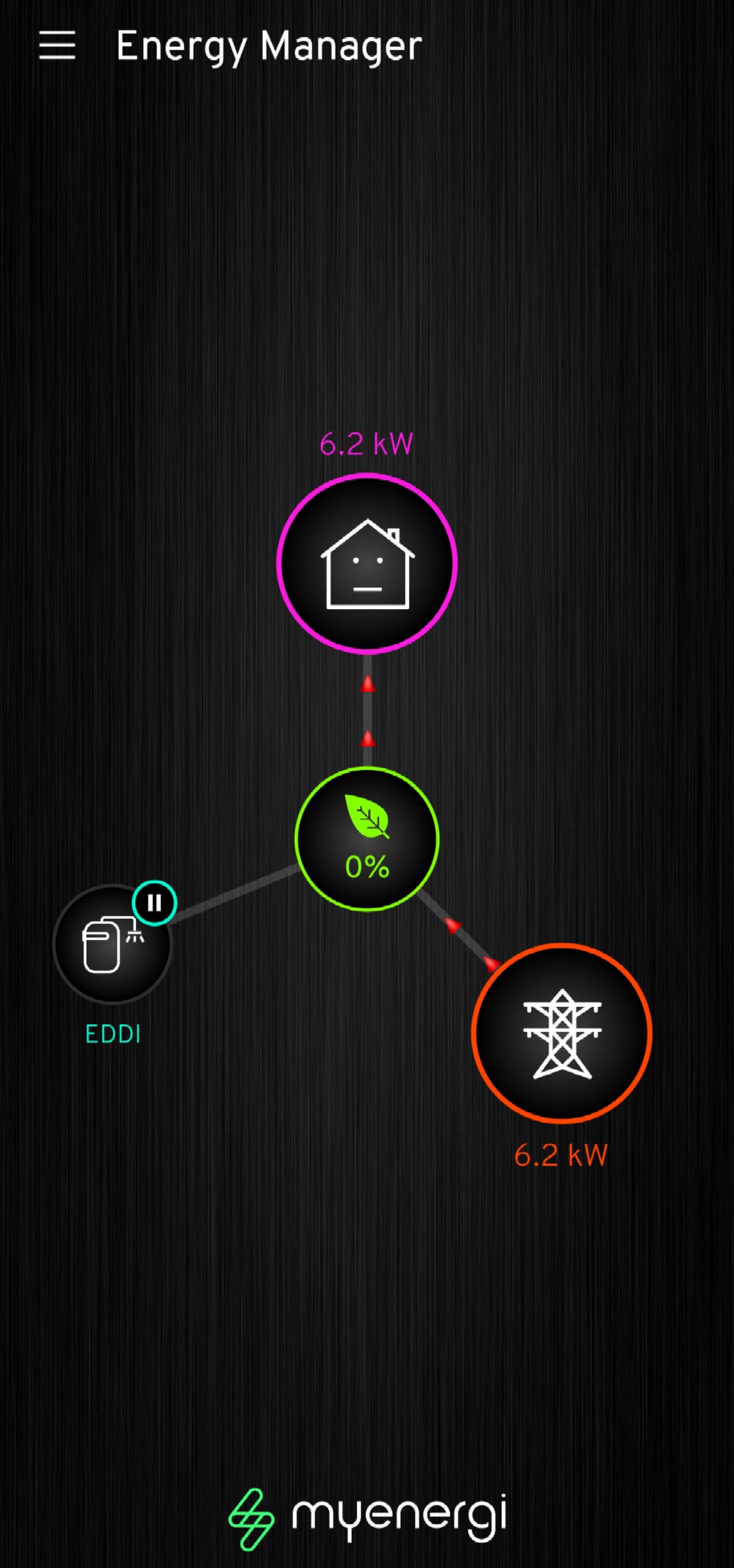

Can you show me some screen grabs of the insights for this harvi? And what specific variables are made available?
Charging my car. That’s within the myenergie phone app.
And that’s from the myenergie Homey app Harvi screen
