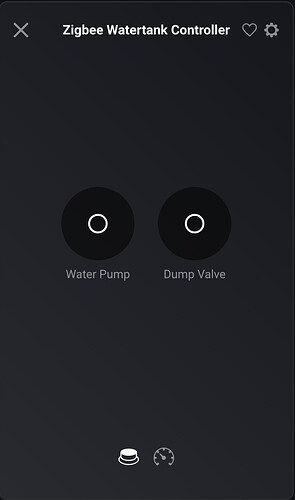

I then tried to change to implement my own custom capabilities:
"capabilities": [
"water_pump",
"dump_valve",
with the capability json as (only showing water_pump as the dump_valve is similar):
"type": "boolean",
"title": {
"en": "Water Pump"
"units": {
"en": "Status"
"desc": {
"en": "Water Pump Power"
"getable": true,
"setable": true,
"uiQuickAction": false
I then update my device.js to do this:
this.registerCapability('water_pump', CLUSTER.ON_OFF, {
endpoint: 1,
set: (value) => (value ? 'setOn' : 'setOff'),
setParser: () => ({}),
get: 'onOff',
report: 'onOff',
reportParser: (value) => {
return value;
this.registerCapability('dump_valve', CLUSTER.ON_OFF, {
endpoint: 2,
get: 'onOff',
report: 'onOff',
return value;
I now see a better rendering of the GUI:
I am correctly receiving updates for both endpoints from the device, and I can now control the pump switch, but when trying to control the valve I get a timeout. I assume I am missing some config to control which endpoint the onoff command is sent to.
Any help would be appreciated.
