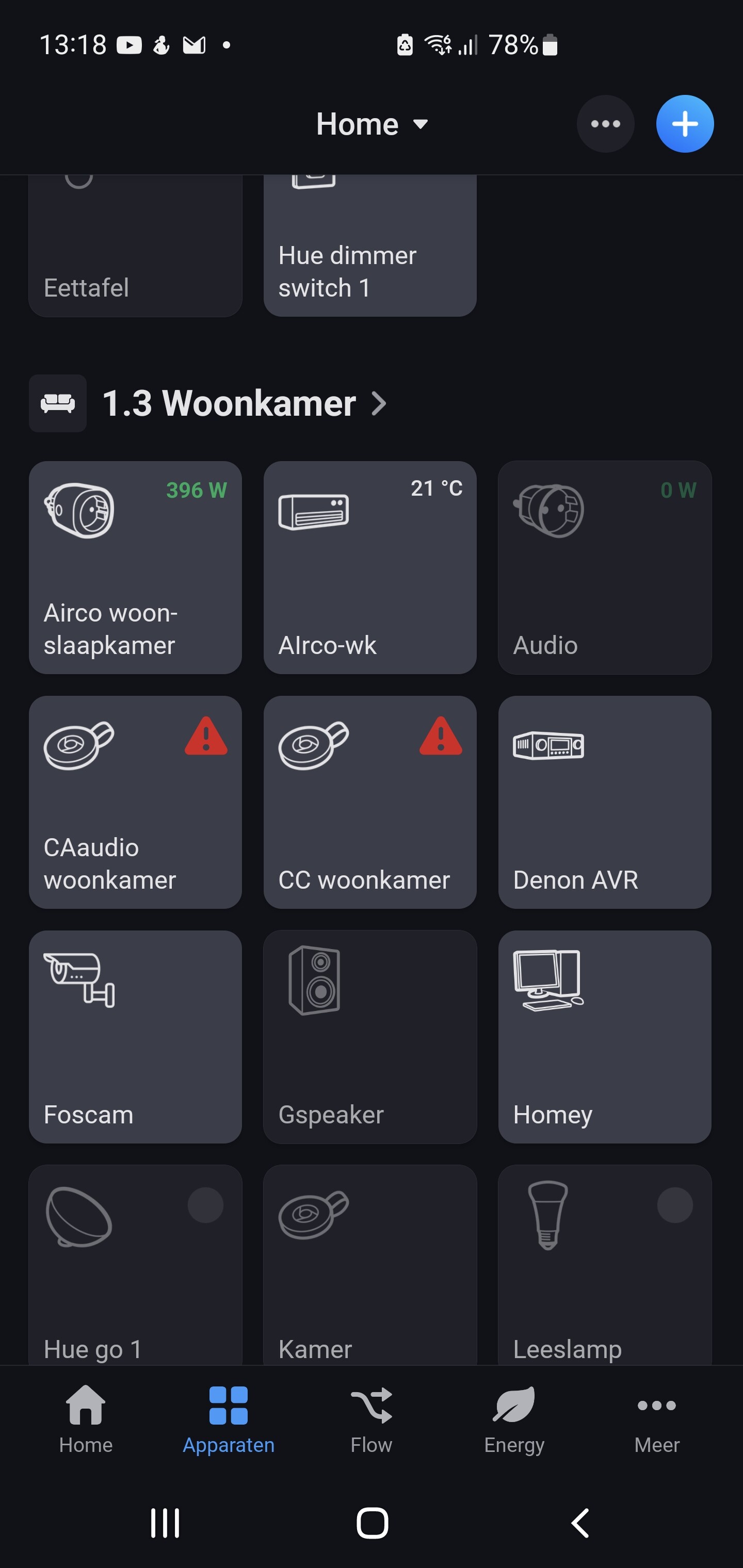

I’m looking for an app or a workaround to monitoring or logging devices with a warming like in this screen ( a triangle with a exclamation mark). Is that possible?
I guess the warning is “device not available”?
The app Device capabilities has a card for this; triggers when a device becomes unavailable.
In order to reveil the cause, maybe the Audit app can tell you more.
But the most common causes are
  • some connection issue (wifi, LAN, internet, manufacturer’s API a.k.a. “the cloud”, zigbee, z-wave, Matter)
  • app issue (crashed, or paused by Homey because of excessive memory of CPU usage, or disabled by a flow you once created)
