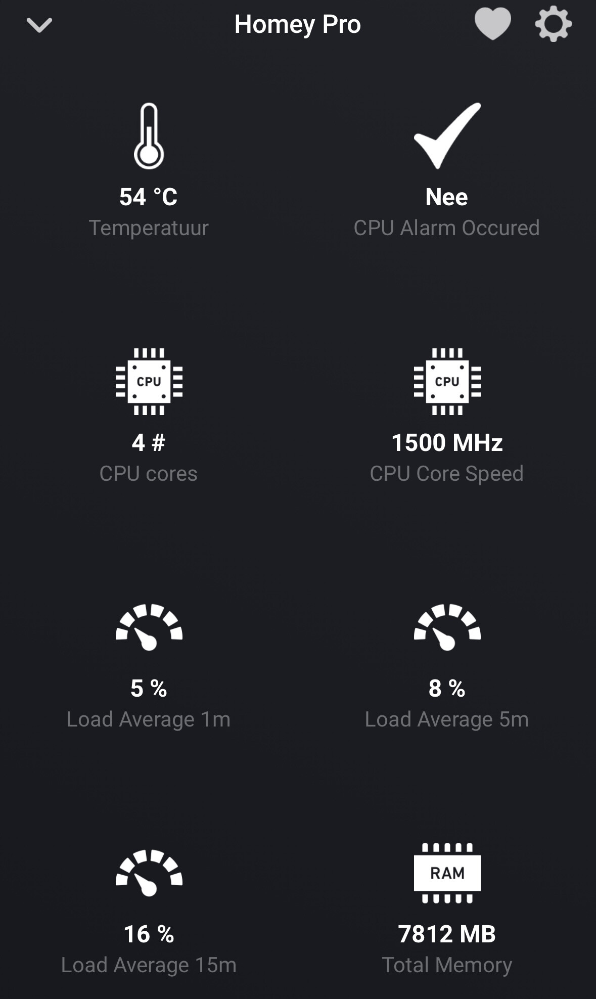

That was emm interesting … Was a pain with my big fingers to get this done … but anyway just restored the original backup and turned on my HP2023. Looks like it is on its way upp and working. @Ranney i had to keep my original heatsink for now because i need longer screws for the new one i have.
Everything seam to work as it used to. 8.2Gb Ram. Lets say it is somewhat overkill but if your going to do something like this you might aswell do it properly i gues…
