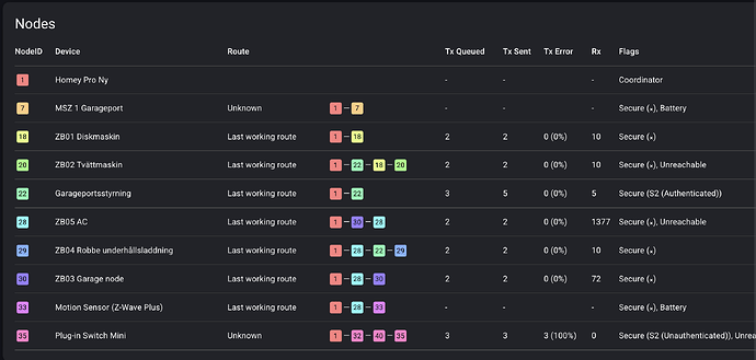

However, the Zigbee and Z-wave meshs (meshes?) is not showing the same improvement. Zigbee is a little better, but Z-wave is basically the same as before the mod. I have nine Z-wave nodes:
and 21 Zigbee (can’t fit them all in one screen shot):
The Homey is placed smack in the center of my house (ground level) and all inner walls are wood, so I thought that the meshs would be no hops at all (like danone’s), except outdoor and basement nodes maybe.
I have no problem controlling devices, so the protocols must be working and the antennas must be transmitting. Maybe I have the wrong antennas? I bought them for the first try and there was only markings on the bags they came in, so I marked them myself. Could I have marked wrong? :thinking: Is there a way to check what frequency the antennas are? To the best of my recollection I bought one 433 Mhz and two 868 Mhz antennas…but now I’m starting to doubt myself.

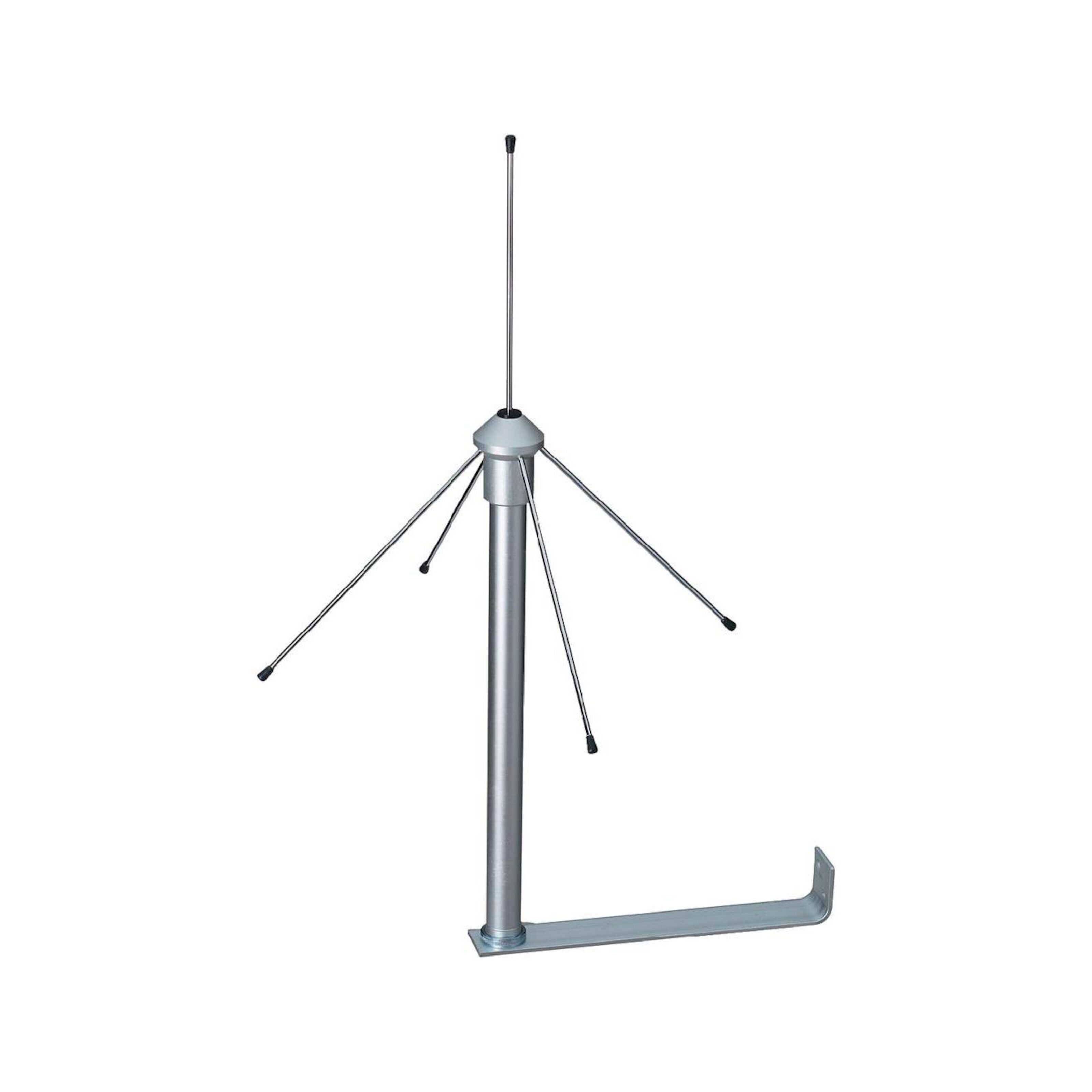

This should do the trick though
