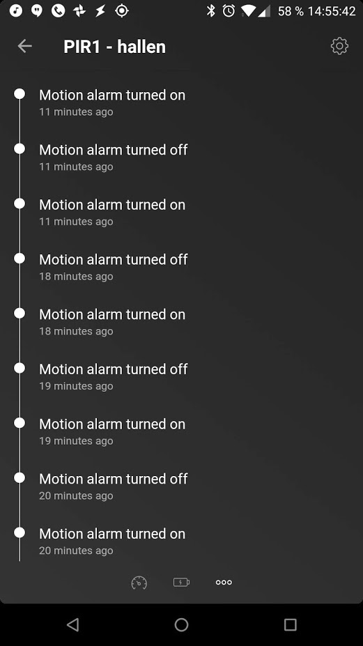

I had this issue the other day again:
Is HomeyScript able to manipulate sensor states?
