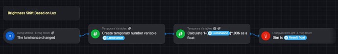

I’m trying to find the best way to have a light smoothly brighten and dim based on the ambient light in the room, based on specific input and output ranges. I have searched the forum but haven’t found quite what I’m looking for.
I created a basic flow which does a crude job of it, but lacks precision.
The basic formula I have started with is “1-(luminance *.36)”

The original form wasn’t accepted by the Temporary Variables app, so I tweaked it to make it work. I changed the “x” to an asterisk, and also replaced the “%” with “*.01”. It works great now!
Thank you so very much for your help Rmb!!
