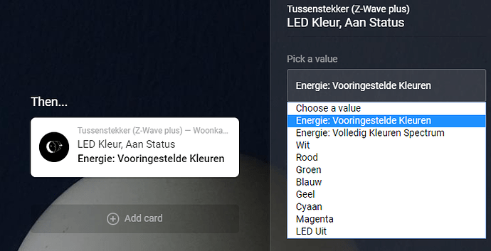

Don’t know whether you can read Dutch or not, but these are the choices for the Fibaro plug:
First two options do indeed indicate energy usage, then you have white, red, green, blue, yellow, cyan, magenta or led off.
And these colors can be set for the ON as well as the OFF position of the plug individually. In your use case you should therefore set both the ON and OFF position to the same color.
